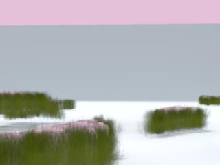

Being a new user of Vray... I've been working with Speed Tree ..... and I'm having a lot of problems with the transparency.....
I saw a topic where the solution was changing all the Speed Tree Materials to Vray Materials.... After 2 hours of trying to understand how it works.... I finally got a good look with the transparency in a mapped based leaf (inverting the output of the alpha map in the Refraction Slot with IOR =1 ).....
The problem is.... that with this material..... a raytraced shadow doesn't recognize the opacity map.. so the leaves shadows are displayed as the whole box of the leaves...... (when you render a Speed Tree with the standard material with Vray shadow recognizes perfectly the transparency, but you get those ugly black rectangles in the leaves.... so you don't have a solution with the material with the black rectangles and correct shadows)
Is the new Vray build supposed to fix this??? or is there something I'm doing wrong with speed Tree???
