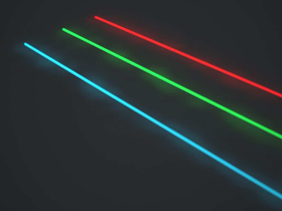

          Here is one example of laser beam created with VrayEnvironmentFog and VrayLight with Directional Parameter set to 1.
          Turning Scatter GI OFF from the Fog will speed up the rendering - currently it is ON.
          Scene file is created with Max 2013.
          Lazer01.zip
            That looks perfect. The only problem I was having was that light was scattering, but I hadn't even considered the "directional" parameter.
