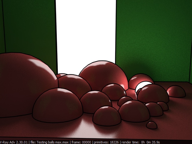

      Is it possible to post an example scene file for this.
      I made a simple test and didn't find any issues.

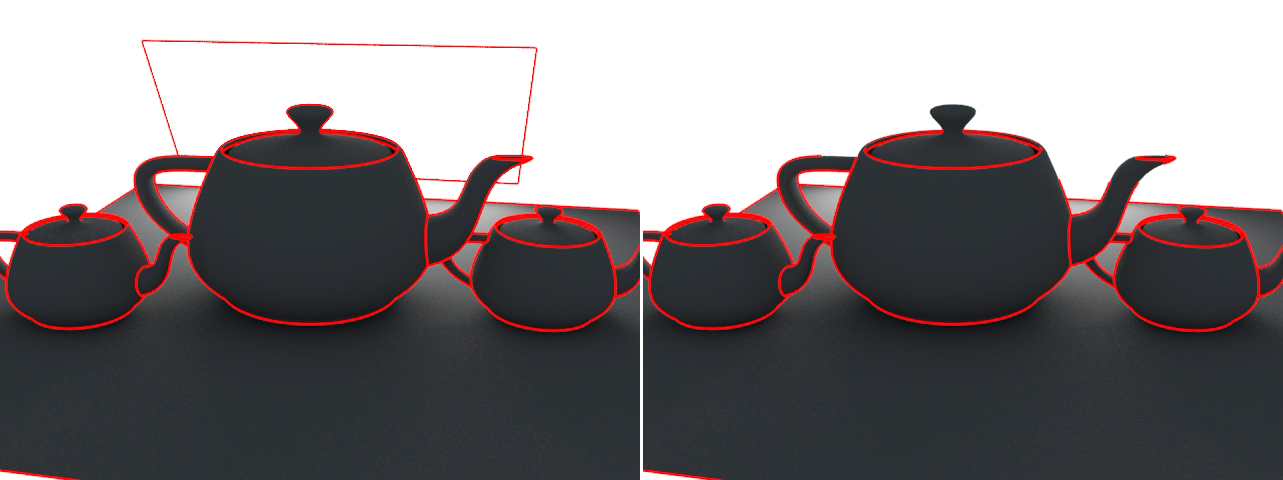

        Hey thanks for the reply!
        It seems that the problem occurs when you make the light invisible. See picture. I`d guess the same then will happen to your scene tashko.

          Hi,
          Thank you, it is reproduced and added to our bug tracking system.
