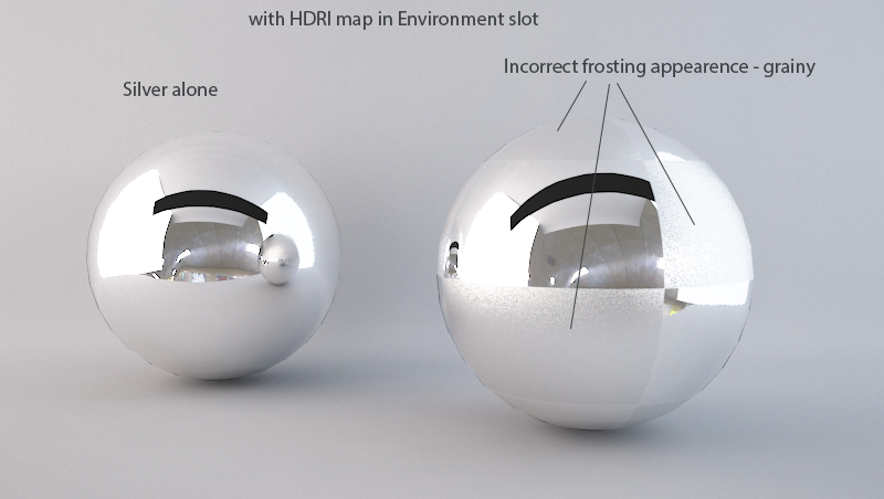

        I can discribe it more: Basically I have a silver object with some regions on it that are "frosted". Frosted is a roughed up, scratched up, or noisy version of the metal but the detail size is really small so it looks uniform and so it breaks up the reflection of the silver.
        When this is all applied onto my object and rendered, without any reflection map, it looks really good. but when I use an vrayHDRI map in the environment slot (which is desired) it pixelates the frosting effect- it looks noisier, aliased, or undersampled.

                  Attached is a scene and some jpegs showing the situation. In image 1, the frosting checker pattern on the silver ball is correct, but there is no HDRI map used. When I add an HDRI map in the environment slot in 3dsmax, the frosting texture becomes grainy looking and aliased. It looks worse even close up. More rendering sampling wont fix this.
                  Please check out the scene and let me know what I missed.

                        Well, through RDP it seemed like there was faceting like you sometimes get with glossy reflections. But I see now that it doesn't look like that. In which case I guess it's just a matter of increasing subdivs for the glossy reflections in the material. Or using a dome light.
