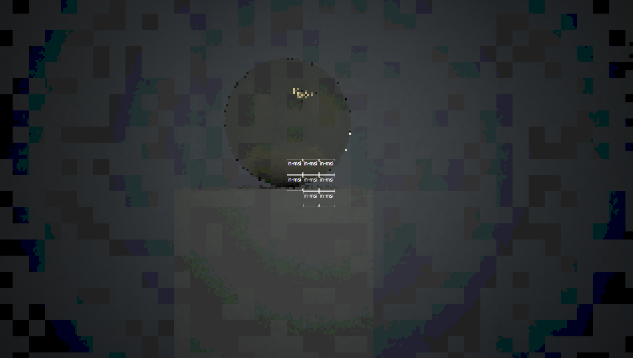

                          Ok it just started happening again, it had been fine for a while. Nothing to do with SolidRocks since I didn't open it for this session. During prepass the slaves either give back black or a very intense and lame color. It doesn't seem to affect the final render though, but who knows if it is or isn't? All my paths are good, it's a simple scene. Any ideas? Or is it just a display thing and it really IS working (no errors in log).

                            Hello Dave,
                            Actually this bucket difference issue during the DR Irradiance map calculations is already added to our bug system and our developers will try to fix it.
                            There is a related topic about this issue here :
                            http://forums.chaosgroup.com/showthr...diance+buckets
                            The final rendering should be fine, in case that the issue is the same.
                            Tashko Zashev | chaos.com
                            • #15
                              Thanks, yes, it doesn't always happen so was hard to track down. The bad buckets do occasionally effect the final render FYI.
