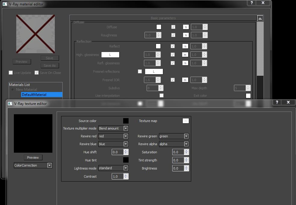

          what is the equivalent in vray for the color correct in max? to color correct the bitmap ? And does the mix of max is supported? if not, what is the equivalent in Vray? And does a Mtl that has let's say a color correct on it will open (with a missing texture because it cannot read the texture that has a color correct from max on it) in Rhino eve if Rhino do not support it? or it will just not open?
            There is a color correction texture in the Vrmat editor. I'm attaching one screenshot.
            You could find Mix Tex there as well.
            Tashko Zashev | chaos.com
