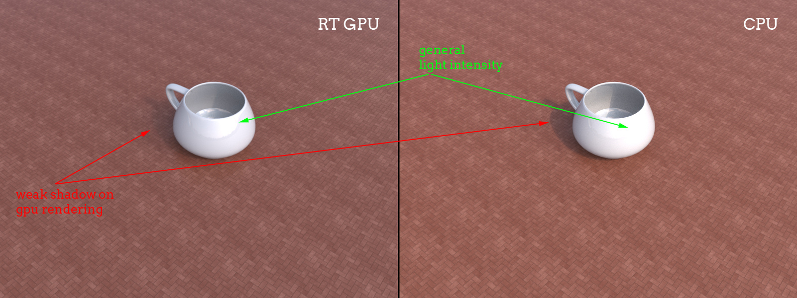

    hello guys .
    I am wondering in anyone has seen a similar situation
    Set up a very simple scene with dome light / vray / vray mtls.
    What i am curious about is that i see a slight difference(shadow strength and light intensity) with rendering production vs RTgpu. the difference only shows with vray sun turned 'on' ...meaning i get same results (good) between renders if using only dome light and exr image.
    Is this a known bug of some kind of special way vray sun interacts with the scene in cpu vs how it does it wit the gpu
Name:	gpu vs cpu.jpg
    murphys law i guess . i think i found the error in the rt engine used . i was using open cl on nvidia gpu's . switched to cuda and prob seemed to vanish
    hopefully this can someone else
    Andre
      alright . it seems to be a bug . has anyone seen this situation before . meaning rendering w cpu production render is different that rtgpu even if all supported features are used.

            vray 3.0 nvidia gpu's , max 2014. .... from my knocking around ,it seems like the dome light integration is perfect and works when this is only exterior light.. but my workflow has a vray sun additionally for stronger shadows... this vray sun light is not being added in RT process. weird !
