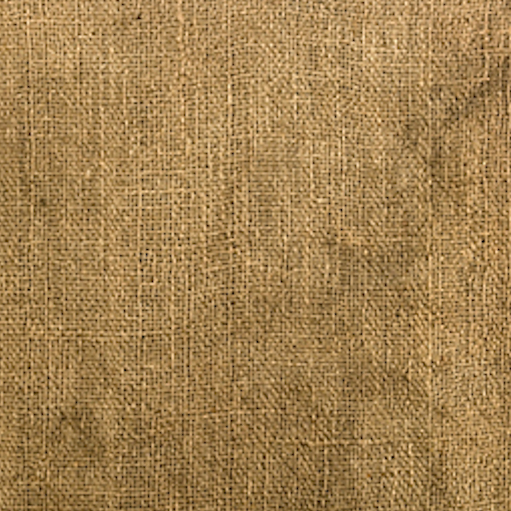

                    The rule is simple: if a texture looks blurry when filtered, its resolution is too low for the intended use.
                    Filtering is needed for magnification/minification of mipmap levels, either precomputed or computed on the fly (tiled EXRs, or single-res bitmaps, respectively).
                    Say you are looking at a textured plane head on, and it covers all of your screen (which, let's assume, is 1024px square).
                    Your texture is 2048px square, and the renderer has to effectively choose which pixel to represent at rendertime, as there are twice (linearly) the pixels needed.
                    Without filtering, there would be no averaging of the pixels (4 into one, if we look at the pixel square), and so the renderer would be forced to pick one out of those 4.
                    Which MAY work for a static image, but will fall apart very rapidly if you zoom in or out or move the plane ever so slightly.
                    On the other hand, say we have a 256px image as texture.
                    Without filtering, again the renderer would have no choice but to pick the pixels it finds (in this case, one texture pixel every 16 in the frame buffer) and repeat them.
                    This WILL look sharp(er) than without filtering, but it will also look pixelated, as the texture coverage is too small.
                    Filtering the texture would, in this case, blur it once rendered, as the average would soften the texture's pixel edges when (under)represented on screen.
                    Filtering of a higher (ie. correct!) resolution texture than its projection on the rendered image will instead stabilize and enhance the texture sampling by the renderer, without appreciable blur (well, no blur at all, if the texture res is big enough.).
                    I'm adding a few samples of this behaviour (image names will tell you what it is you're looking at). Notice one thing: Elliptical filtering is NOT a cure for textures which have too small a resolution (as you can see from the samples, it sits between no filtering, and the standard pyramidal. and still looks crap.)
ID:	855258 Click image for larger version
ID:	855259 Click image for larger version

                        I don't think that's the issue anyone has with filtering or why it gets turned off. It's that if you turn the surface 70degrees away from the camera or something, no matter the resolution pyrimidal turns it into a blurry mess.
