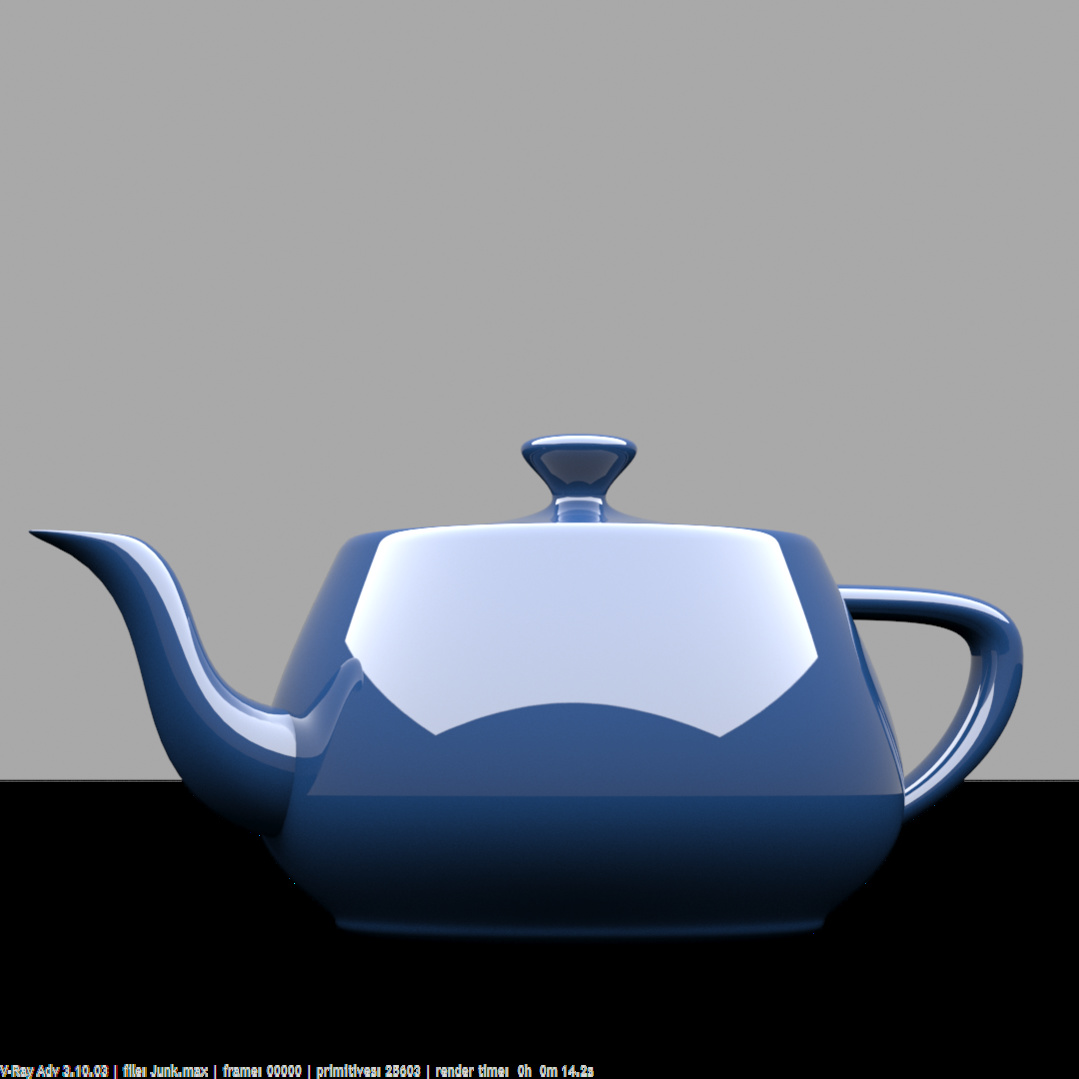

      • #48
        We use Soften at 3.8-4.2 range. Keeping it below 4 is a little faster.
        Note that post blurring is *quite* different from using an image filter. You will never achieve the quality of an image filter with a post blur. To match the image filter you would have to render at many times your normal size and scale down with a smoothing algorithm. This is why the image filter is way better if you can afford the render time.
        Have a look at these. Once you have a bright highlight you can see why an image filter is critical, and why no filter at all is pretty darned terrible. Note how blurring the no filter does nothing to fix the aliasing on the highlight.
        These were rendered at min 2 | max 100 | threshold 0.006. Same hideous aliasing without an image filter even at 0.001 threshold.
        I get that some compositors like things without image filters. We composite stuff flawlessly with image filters, and it would look far worse without them unless we rendered everything four or eight times normal size. But we also tweak the CG to look damned good to begin with, rather than relying on skewing things a ton in the post. This is the advantage of few-artist workflows vs. the old school departmental approach. The artist knows what is best fixed in rendering and what is best fixed in post.
        Area 1.5 (Above)
        Soften 4.2 (Above)
        No Filter (Above) - all aliased to hell - UGLY
        No Filter but post blurred (above) No amount of blurring will fix the lack of image filter. The source image is trash. This has a fair amount of blur, but still shows aliasing because the post blur cannot fix high contrast stair steps aliasing. Sure you could run an edge detect and blur those areas more, but it would still not look right (I have done that too many times with poor quality source material when people first started shooting digital on cameras like the F900)
        The render time listed on the no filter versions is not right. It was 12.9 sec. This no filter version took longer because it was actually rendered at a threshold of 0.001. Even at that crazy setting no filter cannot fix the aliased highlights.
        • #49
          Yes, as i said:
          There are, however, cases where GEOMETRY is very thin, and tends to shimmer no matter the AA sampling, very much like it would in real life (everything has a set resolution. a camera, the eye, you name it.), and then, and only then [...] filtering is introduced, of the blurry/reconstructive type, and this purely because at rendertime we can do so sub-pixel, and with greater accuracy than post could.
          The sharp edge to your highlight is correct, as it is correct that no AA amount should clean it: it is not the AA's task (nor it could be, if you think at what AA does.).
          That's why compers get render elements, with separate reflection and specular, which they can treat with any filter they please (Glare, or Bloom, comes to mind. not gaussian blur. Try it, it's in the VRay FB.), in the selected areas of super-bright pixels (which, again, is correct, and happens naturally with vision, or film.).
          If i got compers overall blurry sequences with blurry alphas/MultiMattes to boot, and told them i did so to fix the highlights, they'd would not be amused one bit.
          But as i said, if it floats your boat, feel free to filter your renders (well, unless you'll ever happen to be one of the artists for which i TD, that is. Which is something i wouldn't want to happen to my worst enemy... ).
          P.S.:http://forums.chaosgroup.com/showthr...757#post631757
          Lele
          emanuele.lecchi@chaos.com
          Disclaimer:
          • #50
            Originally posted by ^Lele^ View Post
            Correct, yes, but you would never see that in an image photographed (motion or still) with a lens. So it is not realistic for our VFX work.
            We do our own advanced glare effects with custom tools in Fusion. I am familiar with the idea, and I do think most renders need some. It still becomes difficult and extra work to fix the highlights, which often tend to crawl without applying what I would consider too much glare.
            As a comper myself I would say the opposite. Don't give me aliased trash I have to wrestle with to make look halfway decent Again, this is the advantage of a comper that knows rendering and knows where the best place to tweak something is, and a CGI team that knows comping. Not every problem is best solved in post. We often find ourselves re-rendering things with softer filters to get them closer to the end sharpness level. Everything is comped at at least 4k or 5k and then scaled down to whatever the final delivery is.
            Yeah, different houses approach things in different ways. We get the best results getting the renders as close as possible to begin with, but not if something is easier/faster in the post. For us, we found sticking with arbitrary rules to make things absurdly sharp and render one thousand passes typically leads to more work and a lower quality end result. I know lots of places still do that, though. Subtleties of lighting seem better captured making the surfaces correctly, rather than trying to clean them up in post.
            My whole point of this little example was to show that unless you want to mess with things a lot int he post, and know a lot of tricks for doing so, you might be better off "just" using an image filter!
