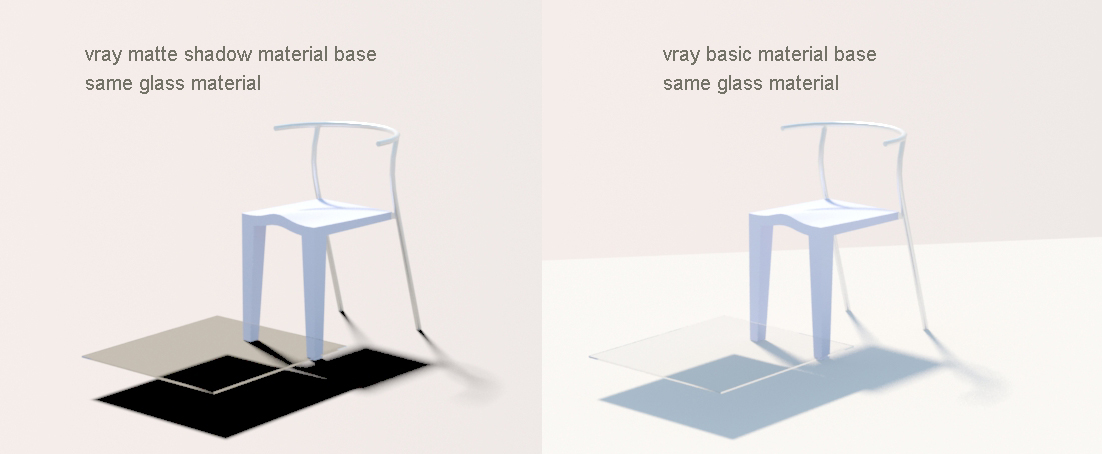

    the pic on the left has a plane with matte shadow settings (notice the glass color is dark and not very transparent, and the shadow is also dark
    the pic on the right is what I am looking for, nice clear glass with soft shadows
    what is the deal here?
    can this really not be done with either matte shadow or with a Vraymtlwrapper?
    what am I doing wrong

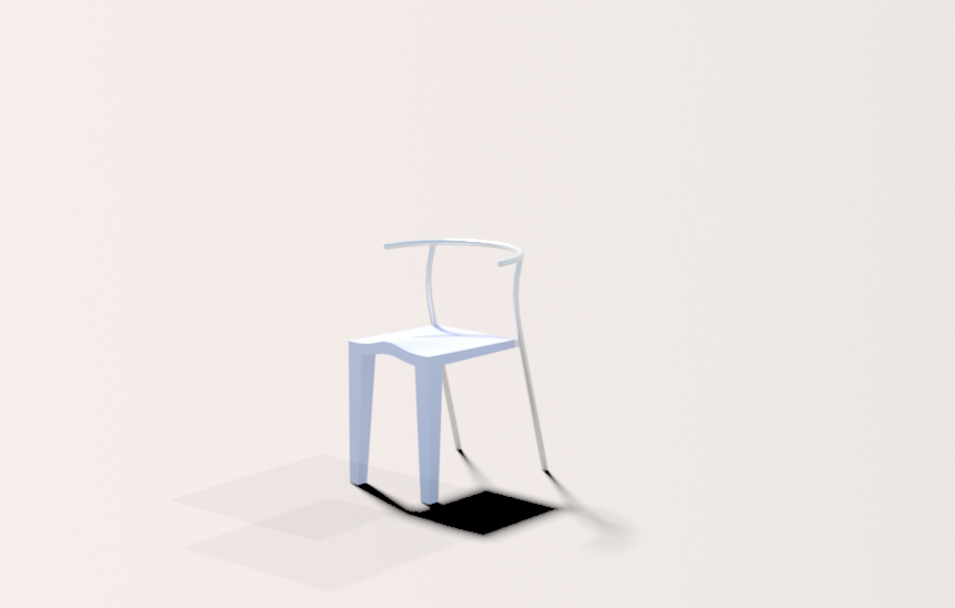

          Activate the Affect Shadows checkbox under the Refraction Layer of the Glass material and the shadow will become transparent.

            the shadow looks correct depending on the amount of transparency, but my issue is more about the glass object itself.
            Why does it look so dark and brown and not very transparent
              Its because the material behind the glass is dark:

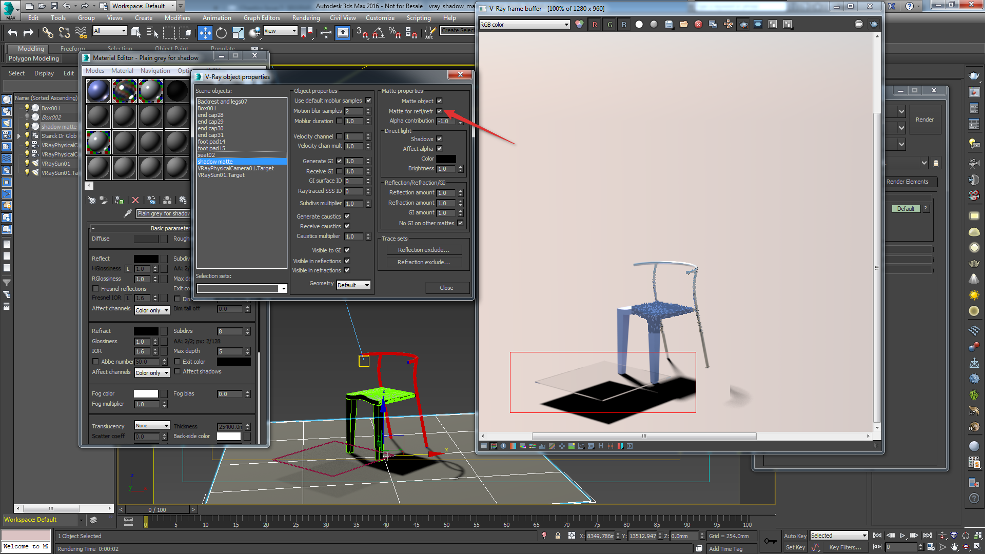

                Activate Matte for refl/refr option from the Matte Properties and Refraction rays that pass through the glass will hit the background instead of matte-plane behind the glass:
                  thanks that did it
                  Activating the Matte for refl/refr option from the Matte Properties solved the issue
