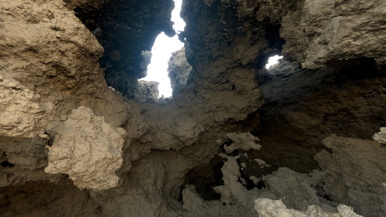

      the purpose is to render the procedural as geometry. . i was loading a simple cube VDB then using the texture surface slot, and cutter geometry to produce the form i wanted as a procedural isosurface. its a similar result to using vraymetaballs with a procedural, but a) it seems to render the isosurface *much* faster than vraymetaball, and b) it doesnt require messing around with particles in max.
      see couple of attached test renders: these took a short while each. the one inside the rock like structure was admittedly an hour or two. the other more distant was only 5 minutes.
Name:	inside the cheese.jpg
ID:	859275Click image for larger version
Name:	5 min render.jpg

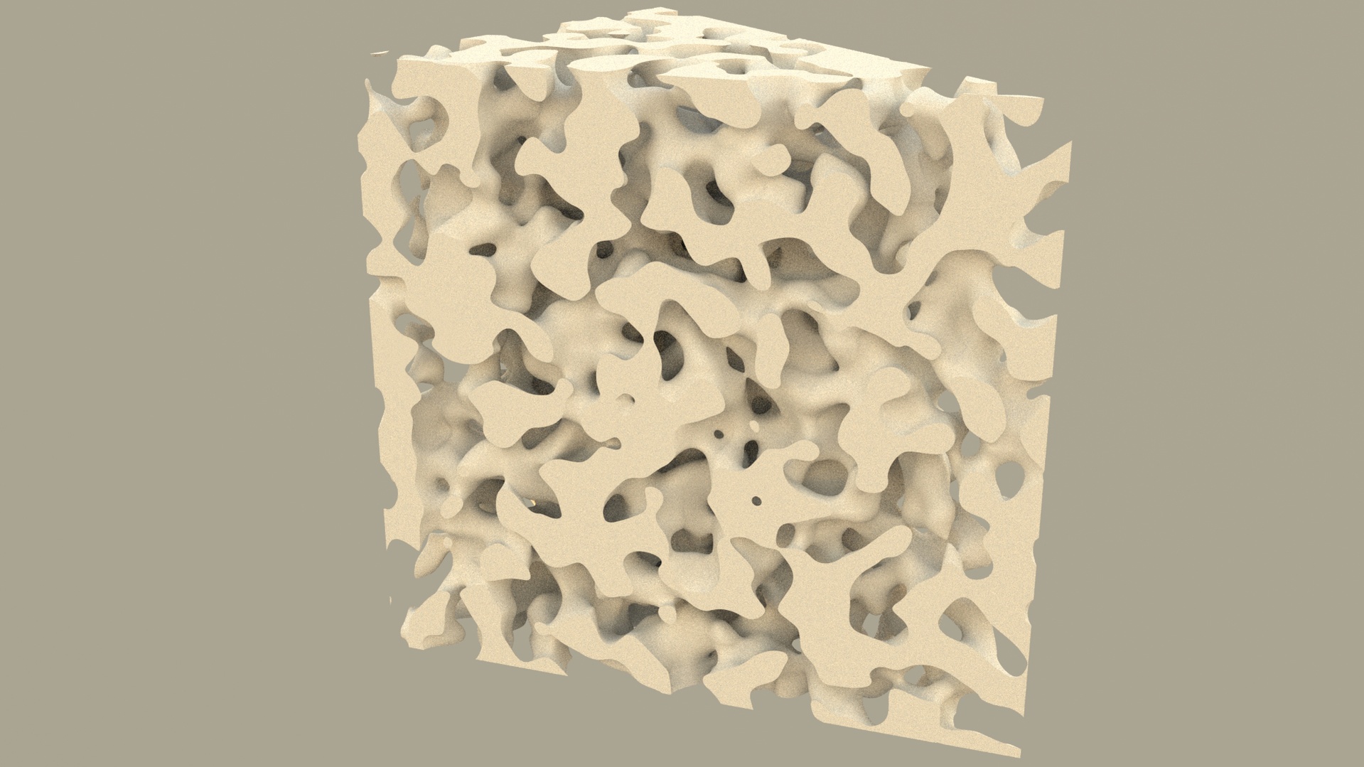

      here is an attempt using vraymetaball that took 7 hrs to render.
      the end result is a sponge or bread like structure. these types of materials are very hard to do in any way other than with isosurfaces.. displacement really doesnt cut it, and i cannot imagine vrayenv fog is a practical approach either. considering the slowness and reliance on particles of vraymetaball, vrayvolumegrid with a dummy vdb file is the only practical way to do this in vray.

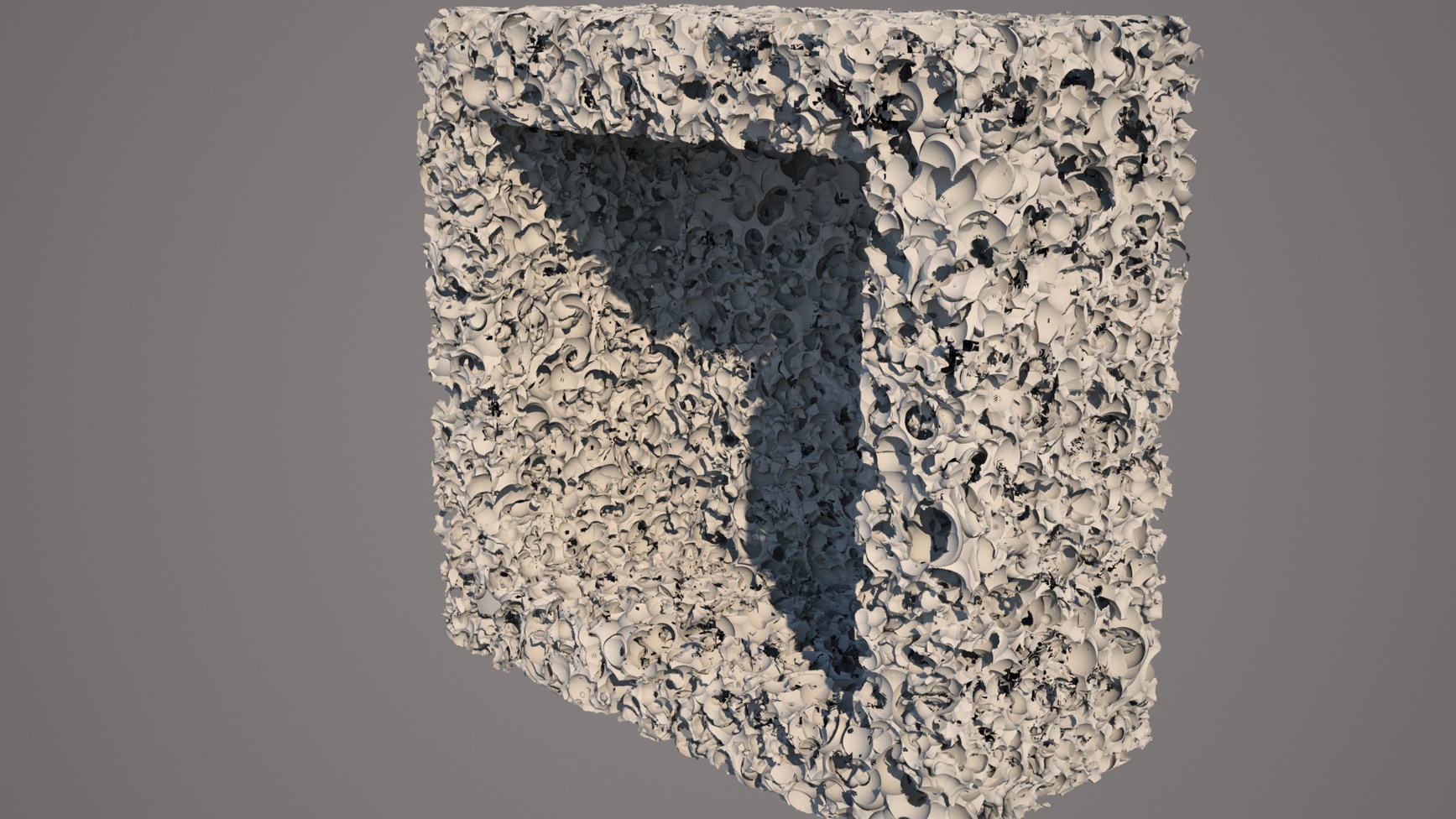

                  a test blending 2 cellular maps with a gradient ramp, with a bit of noise in the gradient ramp slots to mess it up a bit.
                  that is with tiling of 18 repeats for the gradient ramp. it approximately tiles once across the grid with this number. wierd huh?
                  it now needs some texturing based on the same gradients etc, but for that id need extremely different tiling numbers, and it would be very hard to get a perfect match.
