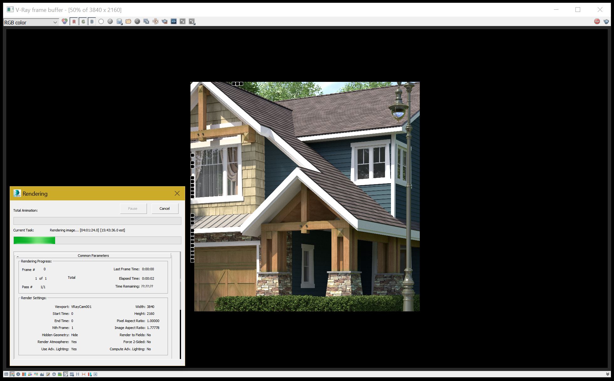

    I have a scene that is rendering out beautifully, however, it is slower than molasses. The roof is displaced, so are the shakes, siding, and stone. If I globally disable displacement, the rendering time drops to around 45 minutes. I am following all the rules to speed up displacement, so it is what it is. My question is, are you guys modeling siding, shakes, and roof? Or, are you just not displacing things? I understand when people talk about fast render times. which I can get also, if I didn't use displacement.

    What initiated this post is a discussion I had with another V-Ray guy, earlier this morning. He asked me what a good exterior render time is for me, and I said I am happy with 4-5 hours, per still. He said that if his render times, for an exterior was more than 45 minutes, something would be really wrong in his scene. After further discussion, I found out that he doesn't displace things. His siding would be a bitmap with lines on it, same with his shakes, and his roofs are just bitmaps. I like the siding to have depth, which adds a ton of detail along trim and other geometry. The shakes look much better displaced for the same reason and roofs with random material id make for a seamless roof.
    Is it worth the time for the extra subtle detail? Is so, is it best to model everything and avoid displacement? Is there anything out there that models the siding and shakes? I know I could rotate walls, use multi-floor and rotate them back, but that's a pain. I know there are plugins for roofs, however, I haven't found them to be very fast to use.
    Yes, the estimated time on the above scene is 15 hours and 45 minutes!!!

    Jip, I feel your pain. I'm going through the EXACT same issue at the moment. Bump mapping SUCK for siding and roof. Displacement is the only way, but it takes forever! A modeled siding wall will render 1000 times faster, but yes try and find a way to do it fast with a wall that has different sized windows, nevermind the gable bit, multi story building etc. Modeling the siding sure will be a huge pain. Hmm I wonder if railclone has an easy option here, I'll check with Paul and report back here
    Also, I wonder how VRayNormalMaps would perform. That's basically a fancy bump map, but at least it looks 3D. I wonder if it will be enough for siding or we'd still fall back on displacement

        If you are using the 3D displacement mode, you can turn on the "static geometry" option and it will be quite a bit faster.
        If you are using 2D displacement, you can try reducing the "precision" parameter from 8 to 1. I hope to do some more things about it in future builds.

                    Model as much as you can.
                    I used to displace things like wall and floor tiles but in the end it is so much quicker to model.

                      I stopped the render, because I wanted to tweak something in the scene, so I set my 2D displacement to precision 1 while I was in there. Yes, it does seem to render faster without any change in displacement quality. It looks like it's going fast enough to turn my DOF back on, which always looks better V-Ray.
