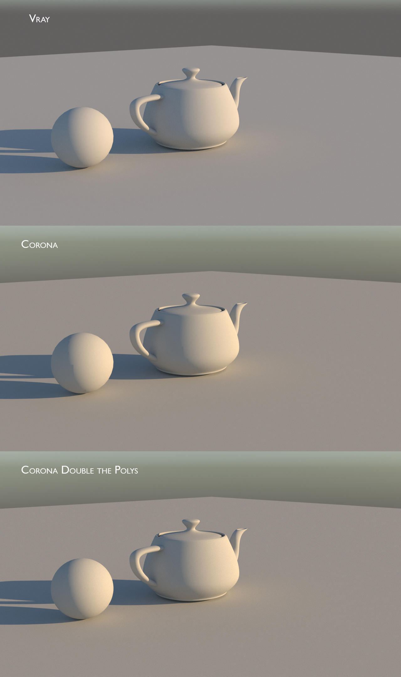

          • #20
            Here is an update on my experience with Corona 1.4, As you can see in the images below corona has a major issue with shadows even with higher poly models. Old trusty Vray has no issues and renders perfectly. Supposedly they are working on this for Version 1.5.
