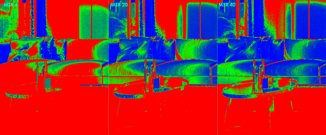

    SampleRate
    Looking at the above, the sample rate is behaving as is expected. The reflection pass on the other hand is a little inconsistent. It's a little hard to see but the reflection quality on the coffee table improves with higher MSR values. With the joinery however, the quality is best at the lowest value of 6.

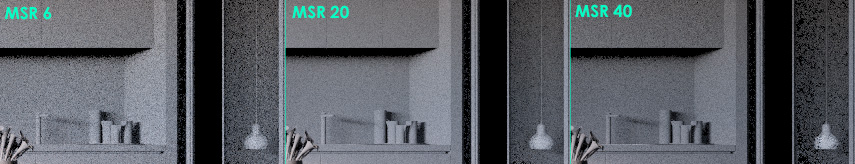

    Rawlighting
    Here with a snippet of the kitchen, you can see how the rawlighting improves when increasing MSR from 6 to 20. Going further to 40 however, gives me a noisier result.
