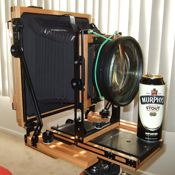

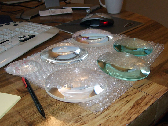

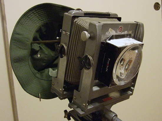

                        Those are fantastic! Especially the ones where you can feel the curvature of the lens as the sides swirl. I was obsessed with this effect in certain large format lenses when I was into film photography, lots of "petzval" type lenses have this effect. I still have those lenses in hopes of someday building a digital large format camera
                        I've experimented with ways of simulating this in Nuke, have found a few decent solutions, but nothing really note worthy. I'd love to get ahold of what you have to recreate them!
                        Some odd experiments with some large format cameras and lenses made from various things, raw lens elements, telescope parts, and what not:
