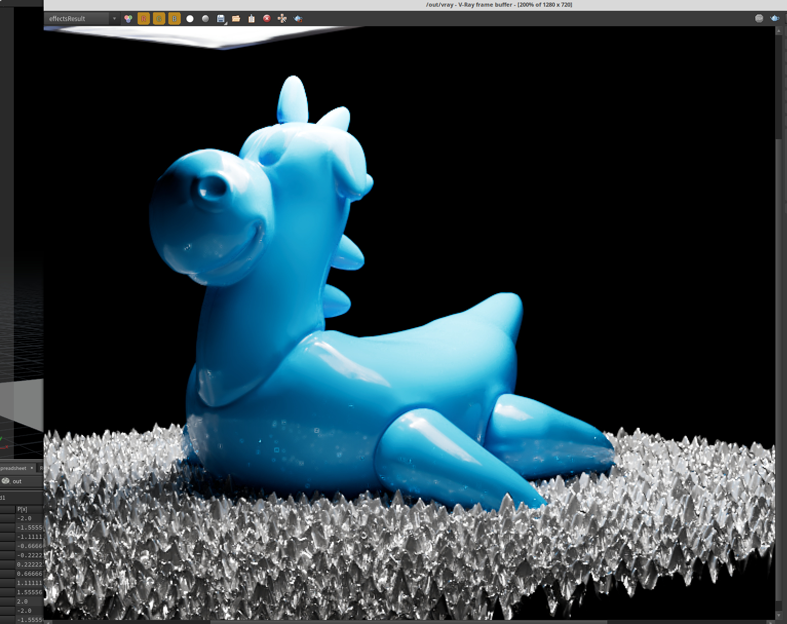

      Because the nature of sampling,this firelfy behavior is more likely to appear on progressive or on gpu progressive. That`s why i stick to bucket for final renders and was looking forward for GPU bucket option. Render from vray for Houdini testing attached. Simple noise grid with reflection, toy, one light and dozens of squared pixels.
      I hope dev can find and improved approach to locate individual biright pixels and threat them differently in denoising process. Vray denoise really is amazing, but few pixels can make a difference between using it and not using it at all.
