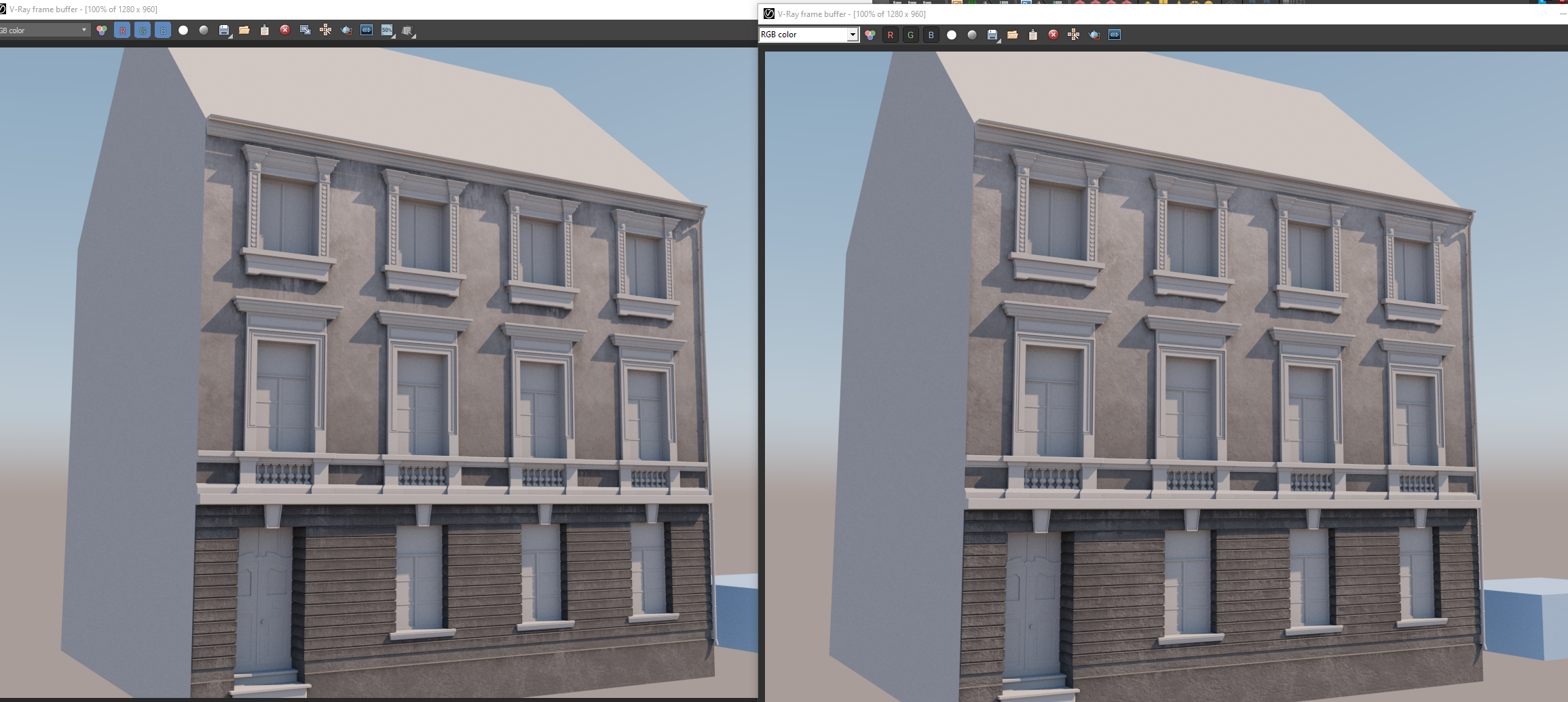

              However, now there are other (though more subtle) differences between the render in vray4max and in Standalone. I'd like to send you the scene for a closer look and debugging but I can't upload it here publicly.
              See the attached image. Left is vray4max, right is standalone.
              1) the overall look of the dirt streaks is vastly different, best seen under the upper row of windows
              2) the bump map strength is a lot higher in standalone
              There could be more but these are the most obvious differences I have found so far.
