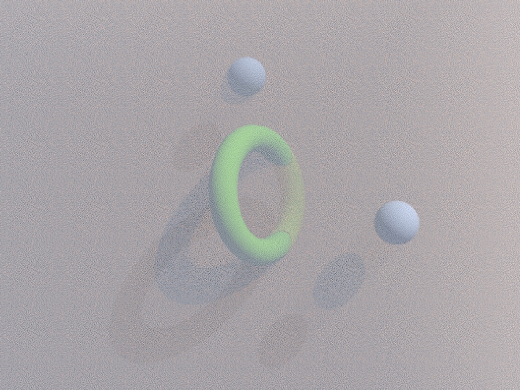

    Here's the Light cache preview. The camera is pointing down onto the water, with the torus half-submerged and some random lights added for testing. Notice the nice volumetrics and shadows in the water:

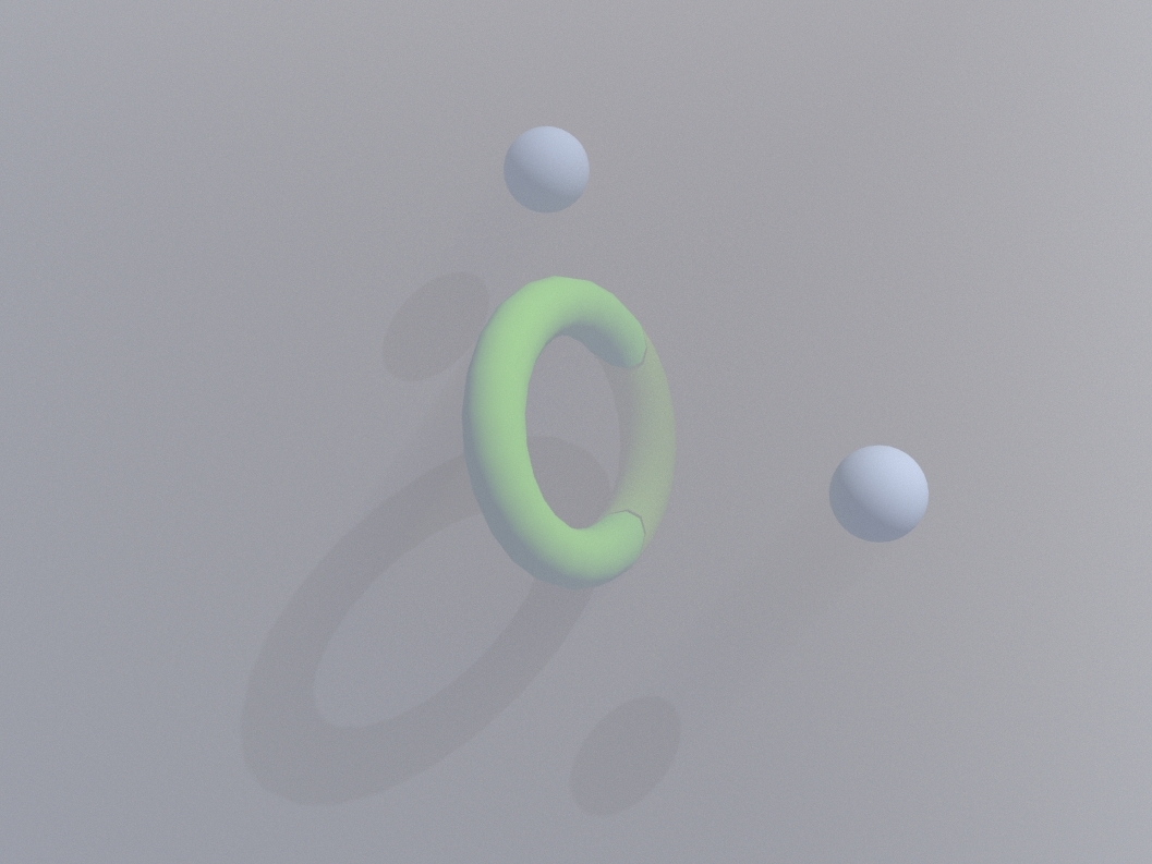

    Here's what it looks like as soon as the light cache is done and it starts rendering for real. All the volumetrics are gone.

    Just to isolate it better, I made a test scene. I made this just using the orange jucice preset, making it white and increasing the scatter radius. This is the light cache preview (Used the "don't render final image" option to stop it at the light cache preview)

    ...Here's the fully rendered result. I can't tell which one is supposed to be correct, but I suppose it's the light cache one.

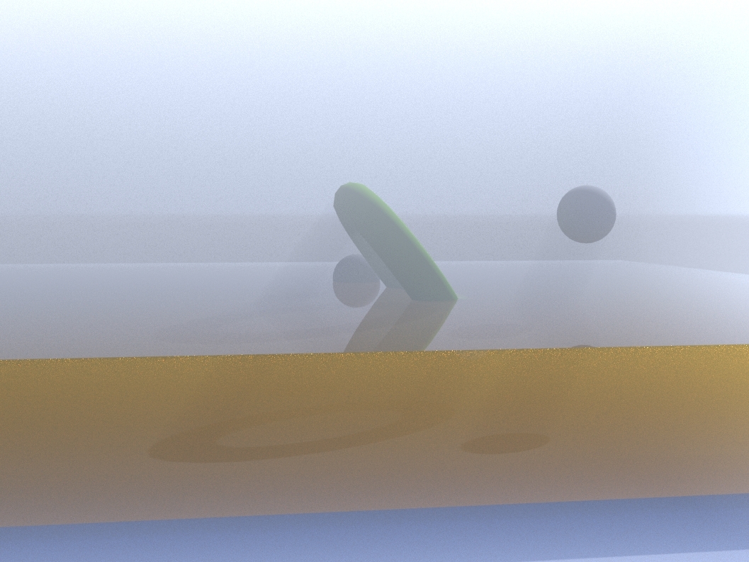

        I tried this - had to guess your setup but it works here. I upped the scale but changed nothing else from the default.
        Of course it's possible this is not what you meant...
          Something strange going on anyway with the LC, as you noticed...here is a similar thing in that same scene I set up...looking from above as yours is.
          Where'd those shadows go?!
          They are there in the previous image but from above they go away, even though it appears I still have the volumetrics.

                The light cache preview does not show the SSS effect; it only collects information for it. The correct preview is during rendering.
                  The LC will not consider SSS at all, i think.
                  You'll see a diffuse/spec/refraction components only for that shader type as the LC builds.
                  The correct render is the final one.

                      The LC DOES work with the SSS, to the limit of gathering info: it won't be accurate at all times.
                      You have scatter GI off, so for the LC that shader was diffuse (as it's the GI engine).
                      Turn it on, the previews will match better.
                      Not 100%, however, and not for very complex SSS paths (i.e. a radius 6 times the size of the object.).
                      VolumeScatter is where you want to go if you need such long paths.
