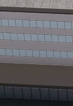

    hello,
    i render out 4k footage with multimattes. if i key e.g. red colour over after effects´ "set Matte" and screw down/up e.g. the brightness i get a white AA one pixel borderline (moirée) .
    noise thesh 0,005/ min1 /max24/ no image filter/ enable filtering in multimatte is "on"
    any help here?
    thanks a lot
    thomes

                  Thanks for the provided scene files, thomes,
                  We've tested this in both After Effects and Photoshop, and seems the expected behavior when it comes to anti-aliasing - as it is taking a variable number of samples per pixels and depends on the difference in the intensity of the neighboring pixels.
                  If you apply a Brightness effect to your mask and increase the sub-pixel difference drastically, it is normal to get fringes.
                  In this particular case, you have a 4K rendering but the building is far in the distance. The unwanted effect becomes more visible when zooming in the rendered output. If you either render a 4K image with the building closer to the camera OR keep it as is and increase the image resolution even more, this will help refine the anti-aliasing as it will produce the necessary pixels for proper sampling.
                  Poor anti-aliasing can be also prevented if a given object is rendered alone on a black background so that issues with alpha premultiplication are avoided.
                  Note that such effects are not necessarily a result of poor image sampling. In general, they appear simply because the image is discretized into square pixels. They can be reduced through the usage of different anti-aliasing filters as well, but are not completely avoidable.
                  Hope that makes it more clear.
                  Nikoleta Garkova | chaos.com
                    thomes Try puting a Levels adjustment after the Set Matte, change the Chanel to Alpha and you'll be able to adjust how "soft" the edge is. Also, put whatever adjustments you use to brighten/darken before the Set Matte effect.
                      thanks a lot both for your information ! i will give it a try the next days ,i´ll be back.
