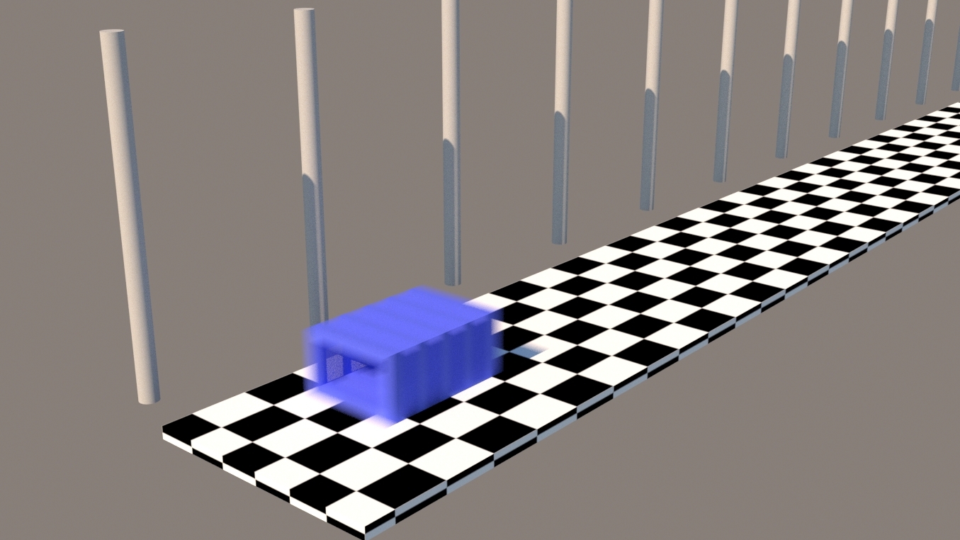

    To achieve this I linked the Vray Physicle Camera + target and the car to an animated dummy object. The problem is the only thing that's is blurred is the car! This behavior seems to me not physically accurate.
    How can I fix this?.
    I attached a simple test scene to illustrate the problem.
    Thanks for your help

      What!??? This is exactly what I'm trying to achieve.
      On my system it looks like this:
      Edit: I'm using Vray 5, hotfix 2

            Are you using IPR? We do have a bug logged with it with major priority, whereby the results are wrong in IPR but correct in final renders.
            Would you kindly verify it's the case?

              Yes, that's it. I didn't use IPR but interactive rendering in VFB. When I use just Render it's correctly blurred. Really strange. ​​​​​​
