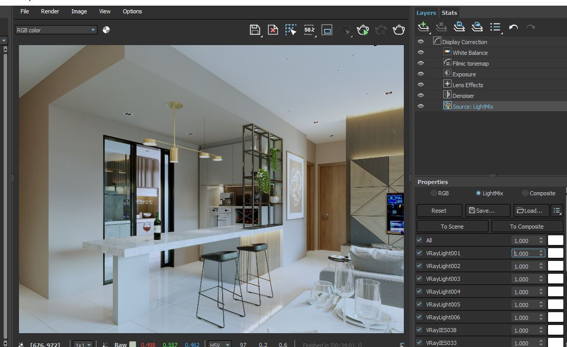

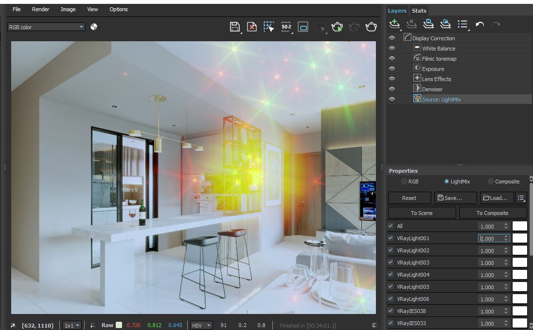

    Hi,
    Do not know why every time when I increase the light value above 1, the lens effects go weird, anyway to solve it?

    You can increase the Lens effects' Threshold value to diminish the effect, however, I'm not sure if the behavior in this particular scenario is correct. Could you send the scene via the contact form so we can take a look? Address it to me in the subject and post a link to this thread in the message.
      Hi, after spent a day with turning on and off objects in the scene, I have solved the problem.
      It causes by a standard blend material on a 3d object, I switch the material to VRayBlendMtl, it works perfectly now.
