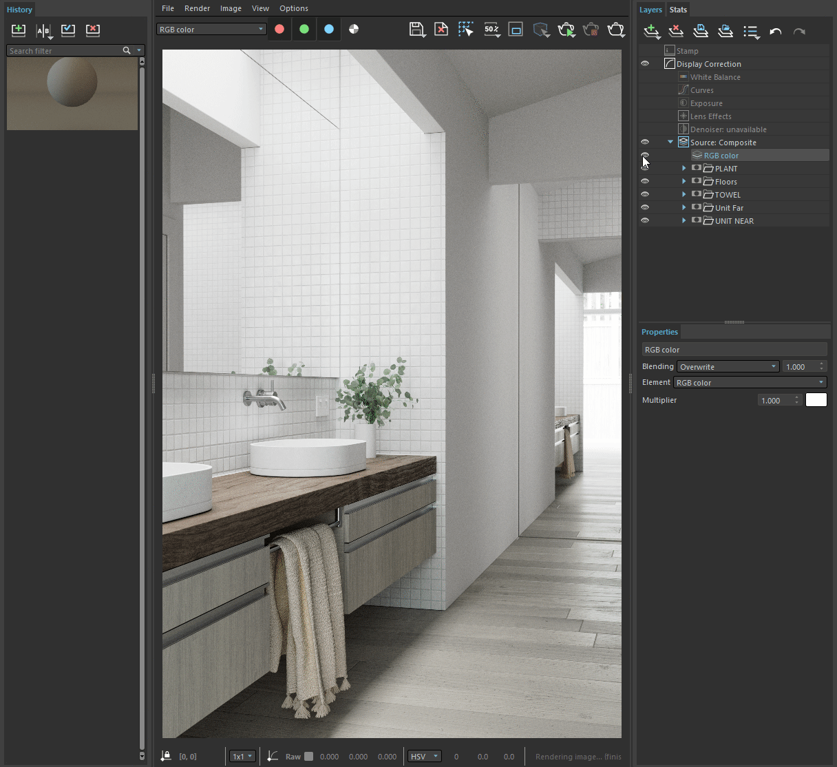

                  do yo mean i have to add a 'render element' set to rgb pass below the AO or Dirt? Because if i do that it destroys any adjustments ive made below. Could you explain the process a bit more?

                    I don't know what's in the folders in you example, but if it's composing properly you need only the AO pass on top with Multiply blending -

                      I was referring to the problem and solution in the thread, using VrayExtraTex with a dirt map, not AO. I've moved my post to the maya section.
