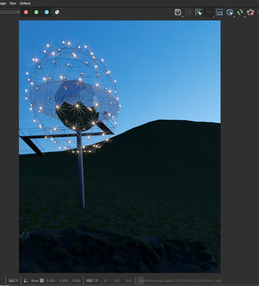

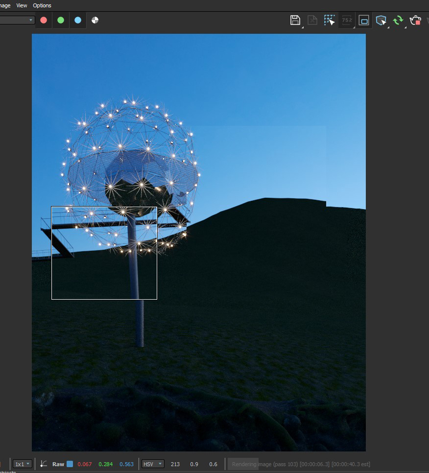

            I will try do a video when I get a chance...for now here are some stills to illustrate. What's odd is that sometimes it happens, sometimes it doesn't

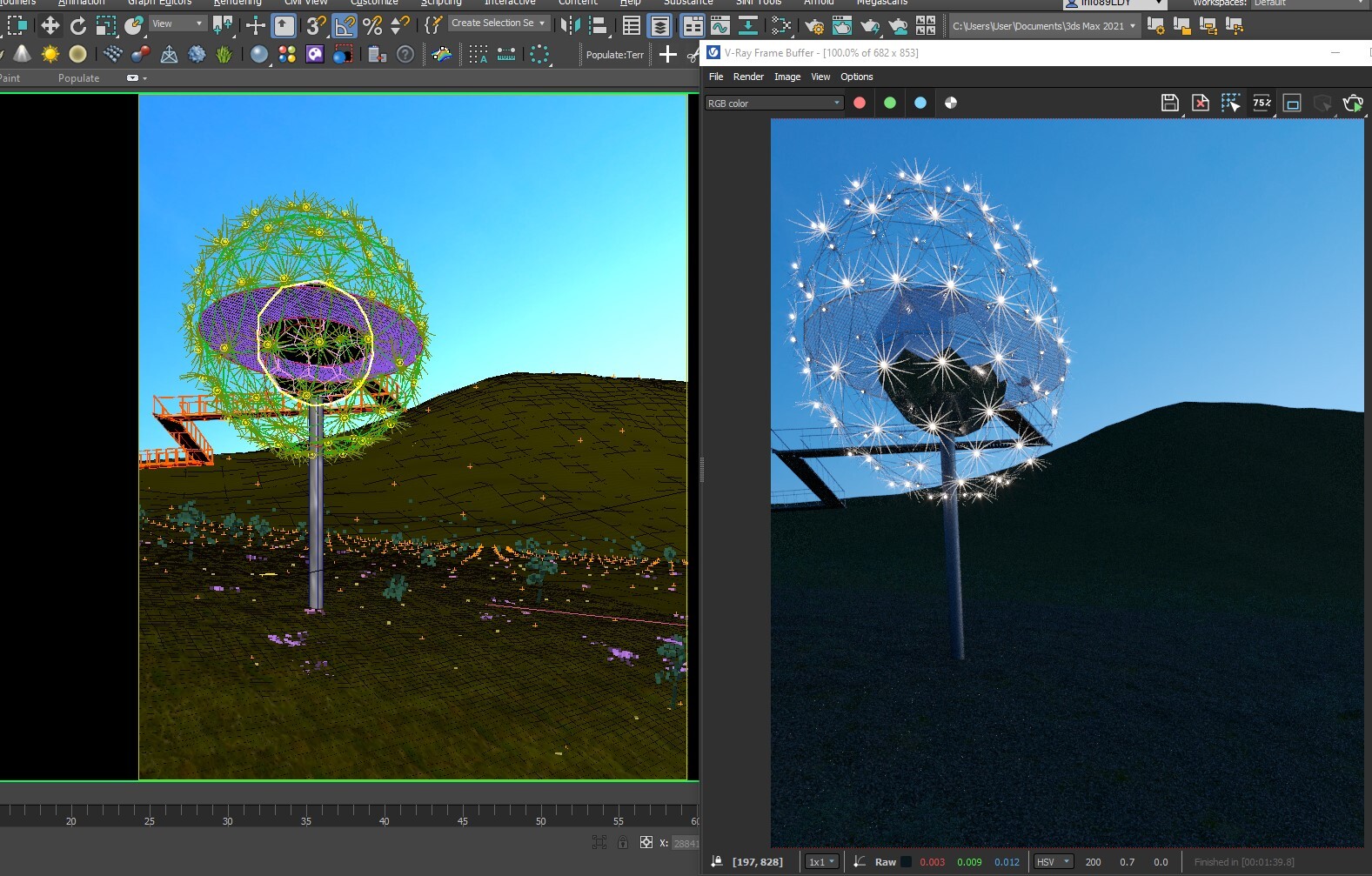

              In fact as you can see in the following still, the rendered window is different from what has been set in the viewport - there's definite tilting and shifting going on somewhere. The column should be perfectly vertical, plus the gap between the bridge edge on the viewport and rendered window is different.
