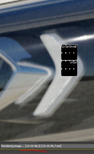

    I hate this.
    Main part of the render was done in under 1 hour.
    ooof thats a hung bucket if I ever saw one! Has that got all the reflect on backside, round corners, blurry refraction bells and whistles on it? I had to start making a closeup and a wide shot setup for headlights for this reason.

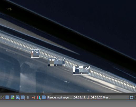

      Happening on every scene we have. It is annoying us to death!

        are you sure it's not a LAN/Ethernet/Switch problem ? I had this as well from time to time (switch changed from 1gb to 10/100mbit)
          No. The cores shown in the image are rendering at 100%.
            And another totally random bucket hanging around for ages.
