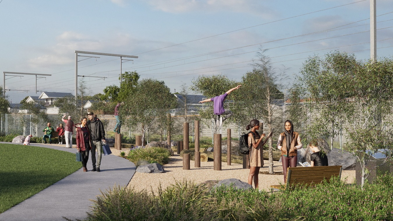

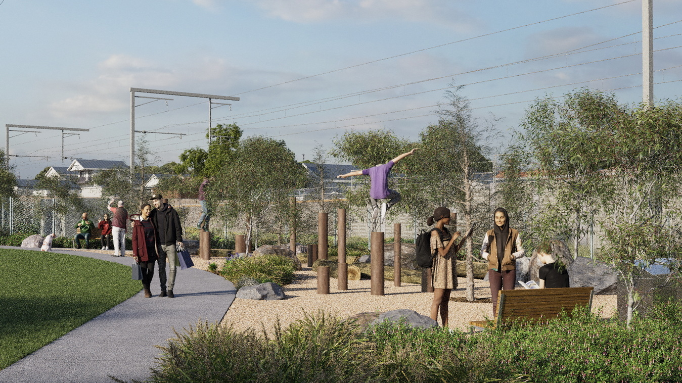

      The people in the attached render named "vrayscene.jpg" have incorrect specularity, making everything look like plastic or leather.
      The people in "Anima_import.jpg" are imported with the help of the Anima plugin directly in 3ds max.

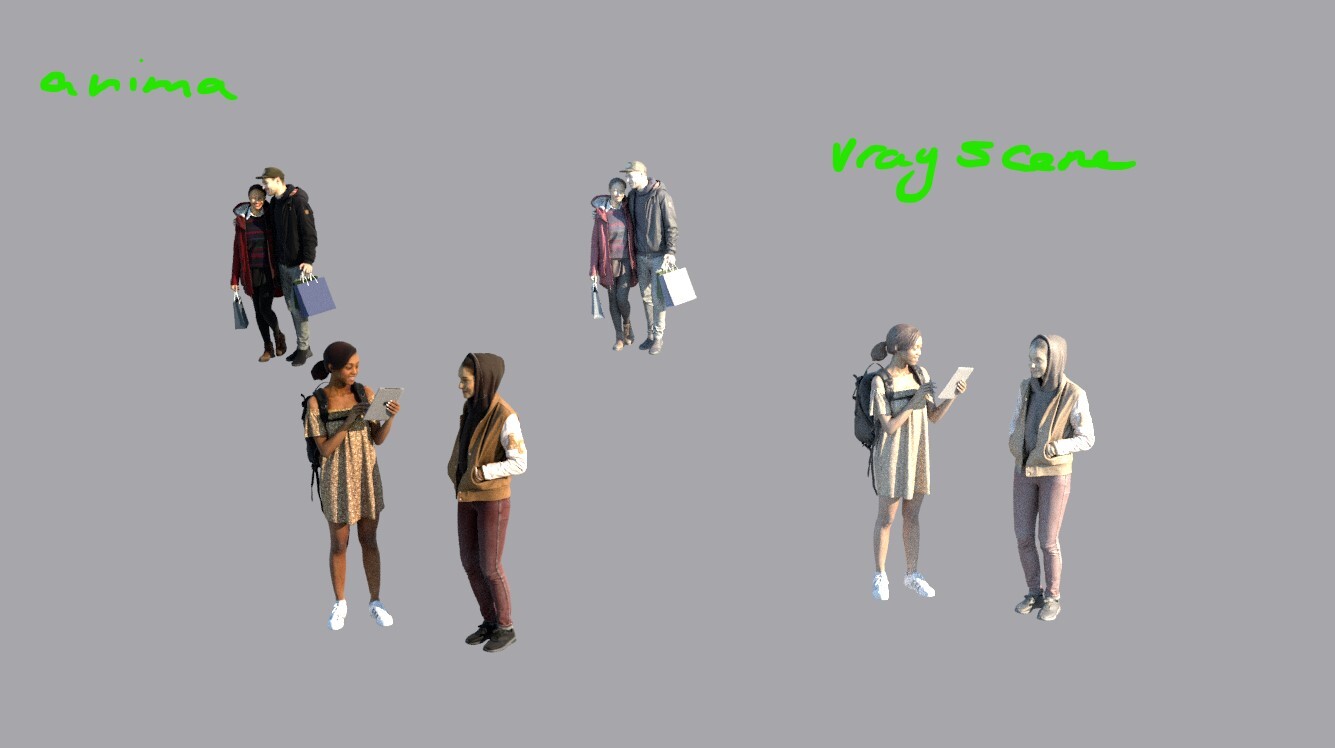

              For comparison i've attached a quick render comparing the vrayscene materials with the ones imported through the anima plugin.
                It doesn't look like just incorrect gamma values. Seems like something entirely different going on.
                    Mh, that looks precisely like maps are coming in with a double amount of Gamma applied.
                    As the shader effects are all driven by maps, it stands to reason they ought to do "more" (of reflection, spec, and so on) as they are "whiter".
