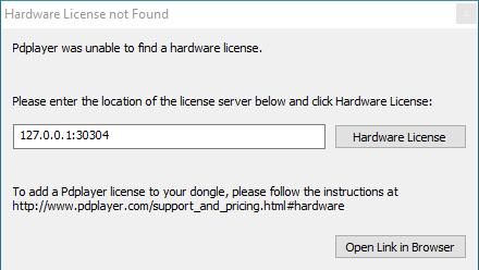

          Hi nikoleta.garkova
          I tried yesterday to download and install it but it seems I need a License:
Name:	PDPlayer License.png
          Is there a way to install a Trial for free?
