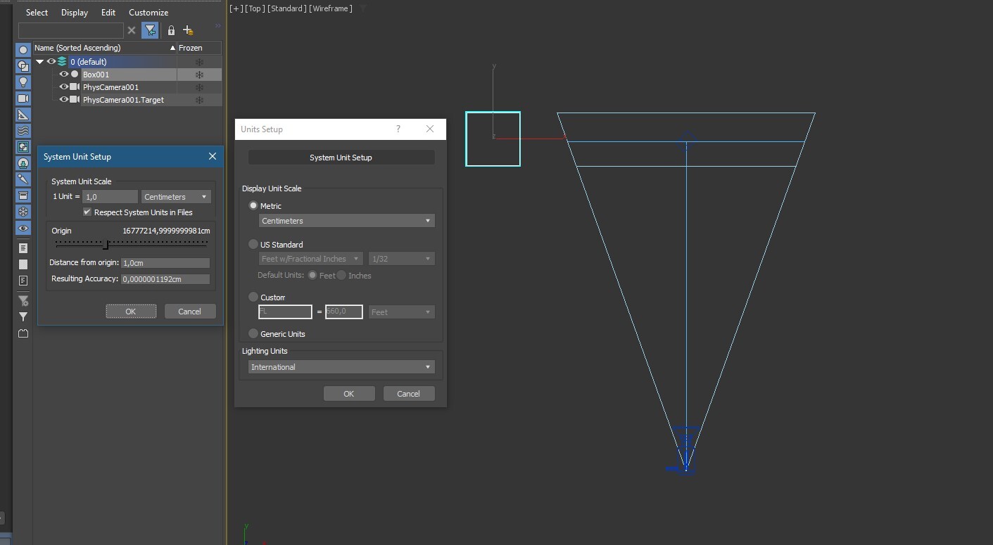

      Hey guys, something is not right here, maybe I am wrong but...
      I did a simple test, and working in cm and with an aperture of 8 the representation of the depth of field of the physical camera of Max is correct ...
      the target is placed at 100 cm from the camera, so the part in focus should be around 15.5 cm for a 35 mm lens, and it's matching...
      Same for the vray physical camera
Name:	Immagine 2022-04-02 114728.jpg
Name:	Immagine 2022-04-02 114018.jpg
      It's the same with the vray camera..
