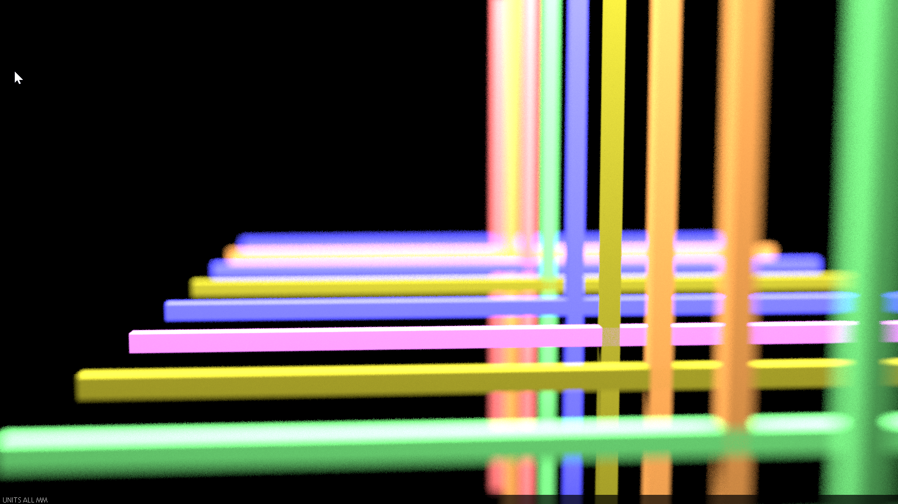

              I confirm that it works with any System Unit Scale, including fractional units.
              I am sharing some test results as requested: DOF_scene.zip
              There are three scenes inside the attachment. Each scene uses different System Units: meters, millimeters, and "inches x 3.14",
              and they are all rendering the same.
              The setup consist of the following scene objects:
              • VRayPhysical camera (Focus distance = 1.6 meters, F-Number = 2.0, no exposure). The camera looks at X direction.
              • Rectangle VRayLight, with a size 2x2 meters and position of (X=0, Y=0, Z=3 meters).
              • Set of 15 horizontal sticks, 20 cm below the camera, placed at a step of 20 cm.
              • Set of 15 vertical sticks, 20 cm right from the camera, placed at a step of 20 cm.
              ​Note that the System Unit Scale should be reasonable for the scene size. Going beyond certain limits could lead to unexpected results, for example - microscopic scale, cosmic scale, or System Unit of kilometers + object sizes of centimeters.
              Edit: fixed millimeters scene in DOF_scene.zip.

              • #52
                One little trick: when the camera is created before a system unit change (that is, technically, a scene rescale.), to maintain the same field of view it's useful to tick "Field of View", so that the camera then takes care of preserving it (in other words, it compensates for the scaling operation.), otherwise the focal lenght will stay expressed in mm, as specified in the UI, and this will lead to FoV changes.
                In the scenes Vasil shared, if one changes the system units (f.e. from inches to mm), the V-Ray camera as it's set up shows a FoV change.
                With "Field of View" ticked and specified, the change does not happen, the FoV remains consistent.
                DoF however will change as it should (it's the same behaviour in the Max Physical Camera.) given the camera sensor hasn't scaled with the scene.
                So changing the scene units to mm from inches will make the scene minute (notice the boxes' sizes) and make the DoF enormous (at that point, one's macro-photographing.).
                This is the expected behaviour.
                Lele

                    The mm scene that Vasil included is in fact set to System/inches and Display/metres, as is the 'inches_by_pi' scene, so there's no mm one to check/compare.
                    I anyway set this up in a similar way, though merging the same assets into scenes set to System units of respectively metres/cms/mm, though all with display units set to mm for consistency.
                    After merging each, then setting the camera to the same mm parameters each time, the results are indeed basically the same, bar some shading differences.
                    Setting it to kms, out of interest, broke the camera....it needed to be zoomed out in order for it to be in the frame, and when zooming I could see the focus planes snapping from their position to what looked like the camera pivot point.
                    I suppose that's a rounding error but thought to mention it.
                    • #55
                      It was another false flag for me, sorry about that.
                      Hopefully it helps clarify things.
                      The (evermotion) scene came with cm, and a focus distance of 20 meters.
                      So by changing system units to mm i scaled it down 10X, making it a macro shot, with a 10X closer focus distance, which in turn decreased the depth of field.
                      In fact, to get a properly narrow depth of field, it's enough to focus the camera closer, f.e. 2 meter away.
                      To recap the thread and its findings:
                      Any system unit can be used (that's why Piotr and Francesco's tests also worked.), but it cannot be changed freely after the camera has been created, as that scales the scene up or down, without scaling the camera system, thereby changing DoF/focus distances and so on.
                      Lele
