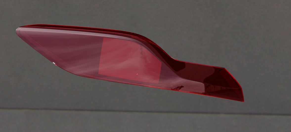

      Originally posted by Dart_Design View Post
      OK, can you please tell me, may this particular issue to be resolved in vray 5?
      I can try with 6 Beta.
      EDIT: Here are the results, that particular issue is not fixed yet.
      First is regular part, second has elements flipped in Edit Mesh, third has elements flipped in Edit Poly.

      • #18
        That isn't the same issue though.
        The one from the OT *is* fixed with 6.0.
        Flipped normals are altogether a different matter.
