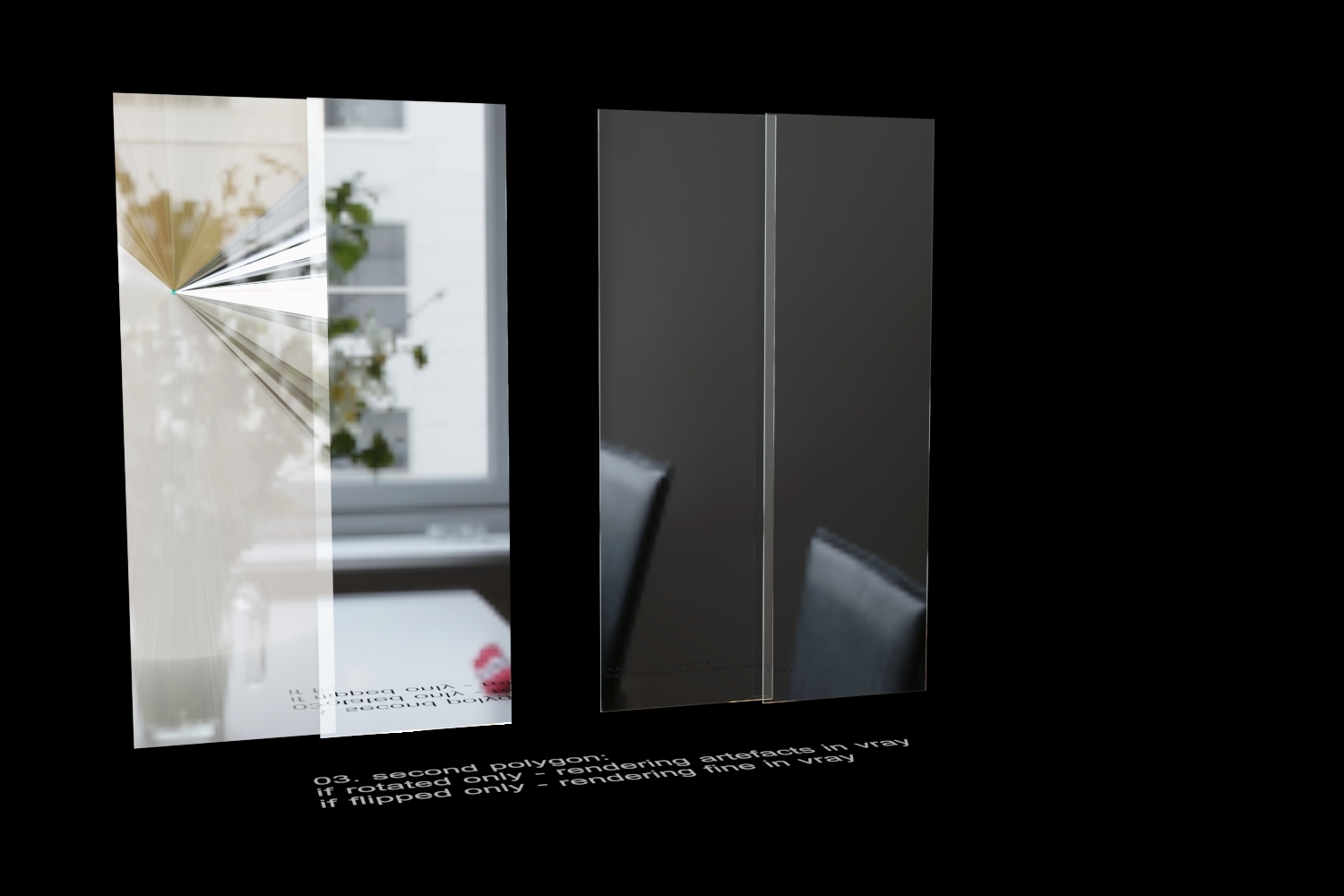

    Hello,
    recently I found a strange vray material behavior when using glass shader with imported parts (MOI3D->3ds max).
    In some cases, it causes reflection and refraction artifacts. Maybe it cause other artifacts as well, which are not so clearly noticeable.
    To reproduce the artifacts:
    01. take some imported sheet of something from MOI3D (it comes with explicit normals)
    02. select one polygon -> inverse -> delete. Then copy the polygon in sub-object level and add shell modifier - everything renders fine
    03. rotate (not flip) one of the polygon with shell modifier active and you can immediately see the reflection and refraction artifacts. They make bend and tunnel effects. The whole surface also looks more like mirror.
    04. if you add the edit normals modifier, then the problem is gone. you can also break the normals. (tried in vray 5, not sure if it works the same with vray next)
    UPD to 04 : the problem is still there if you rotate/flip the polygon again or copy the object (tried with vray next). The only solution in vray is to add edit normals modifier -> select all normals-> reset (normal vectors should have a blue color)
    This problem exists in vray next and latest vray 5 versions.
    Glass shader is very simple:
    diffuse - black
    reflect - white
    refract - white
    color tint via fog
    IOR 1,52
    reflect on back side
    GGX + Glossy fresnel.
    At the same time corona renderer 8 has no problems with handling such geometry at all (tested on legacy material and physical material)
    Please look at the attachments and tell me if you need the scenes for investigation.
    Best regards

                The second problem that you mentioned is because of the shader. Please take a look at the attached file.
                If you untick Reflect on back side the issue seems to be fixed.
                Also take a look at this thread. https://forums.chaos.com/forum/v-ray...on#post1054374

                  Hi, thanks for looking the scene. Yes, with no back side reflection it renders fine. This can be used as temporary workaround in cost of shading quality, but the overall situation is not normal.
                  I also have the Issue #3, which I believe has also the same reason somewhere under the hood. It relates to metal shader with Anisotropy. We get same wired lines there. I'll prepare & post it a bit later
                    I cannot repro the issue with the most recent beta for v.6.
                    Would you please check it's gone on your side too?
                    p.s.: The shading models between render engines aren't identical. F.e., in your glass shader you changed the GTR tail falloff, something impossible in Corona.
