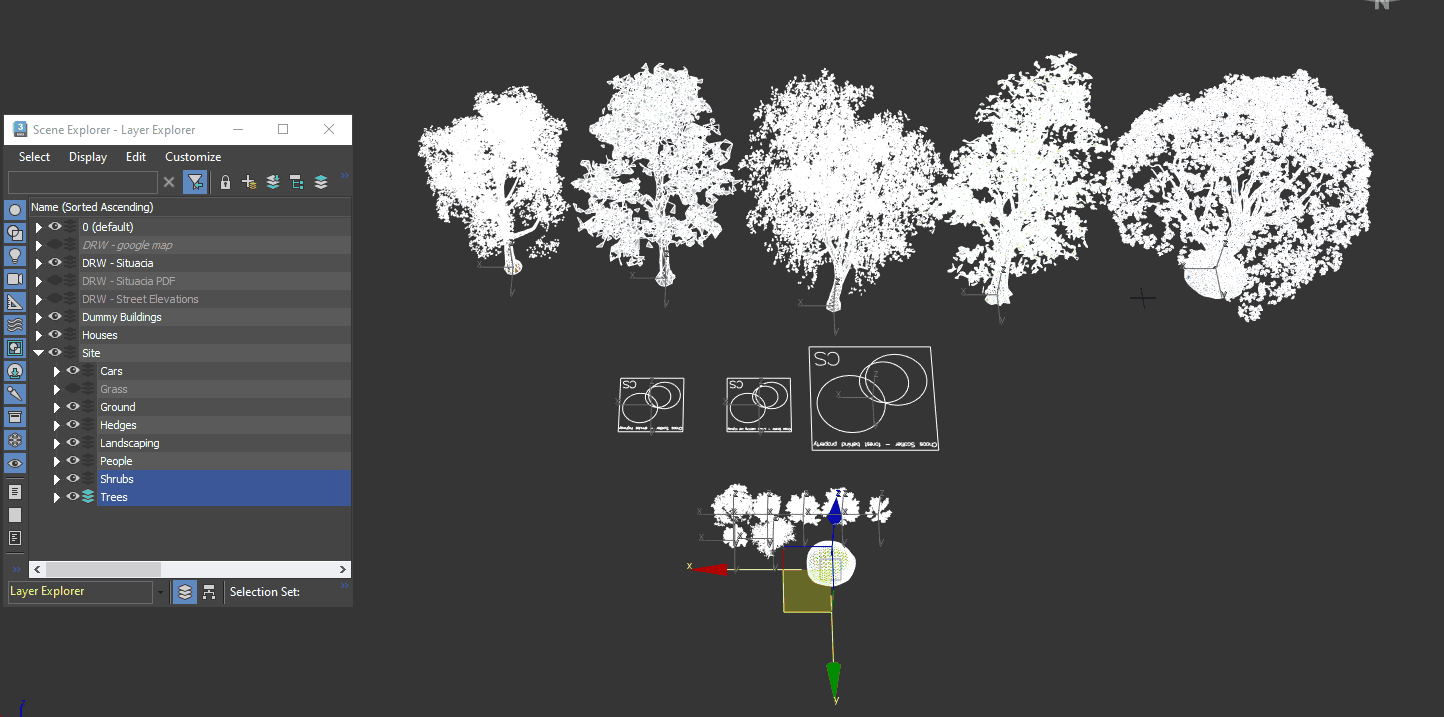

          Yes, all Chaos Scatter objects and all models that are scattered are inside the excluded "Shrubs" and "Trees" layers. See below. By the way, I've just replaced all Chaos Scatters with Forest Pack scatters. No issues now. Seems like problem with Chaos Scatter.

            Hi Alex. I'm glad that you found a solution. The issue is transferred to our developers and we will look into it. It would be great if you can provide a scene including only the problematic objects. You can attach the scene by submitting a request from your Chaos account panel. This will help us as a starting point. We appreciate your effort and time.
