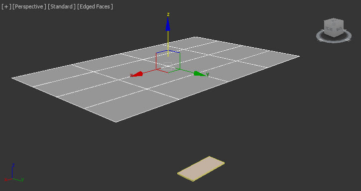

    OK So I decided to try out the VRayEnmeshMod
    Very simple scene, a plane and a box
    I added the VRayEnmeshMod to the plane
    I added the smaller box to the Objects list
    Ran VRay IPR
    and nothing

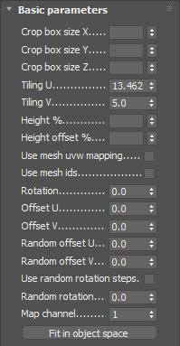

    Looking at the Basic Parameters list
    Crop Box size X,Y and Z are empty and also Height% and Height Offset are also empty
    Anyone know what it going on here. The scene is as simple as it could be. Max 2018 and Vray 6 Hotfix 2

          Weird... If I use IPR mode, I get no result, If I use Production mode it renders a result and if I stop it and continue using IPR I get a result, but that still doesn't explain why the basic parameters for the Crop Box Size X,Y and Z and Height % and Height Offset are empty.. and clicking on the scroll bars, has no effect, they are simply empty
            Also entering numbers in the empty boxes, has no effect whatsoever.

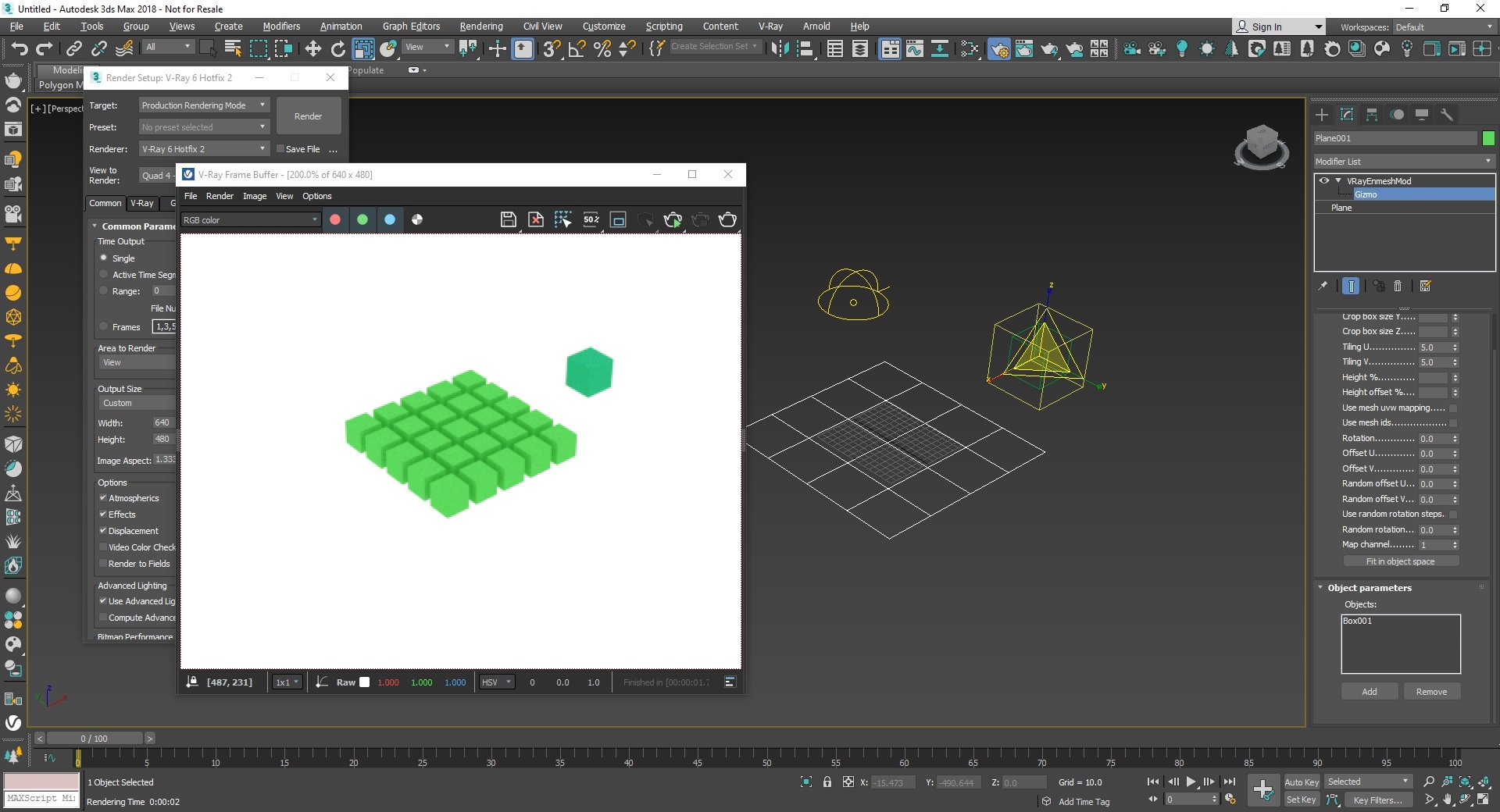

                  Hi you are right something strange is going on in 3ds max 2018/vray6 and VRayEnmeshMod.
                  If you select and scale the gizmo manually it will work on my end. But still there are issues with the crop box input dialogs.
