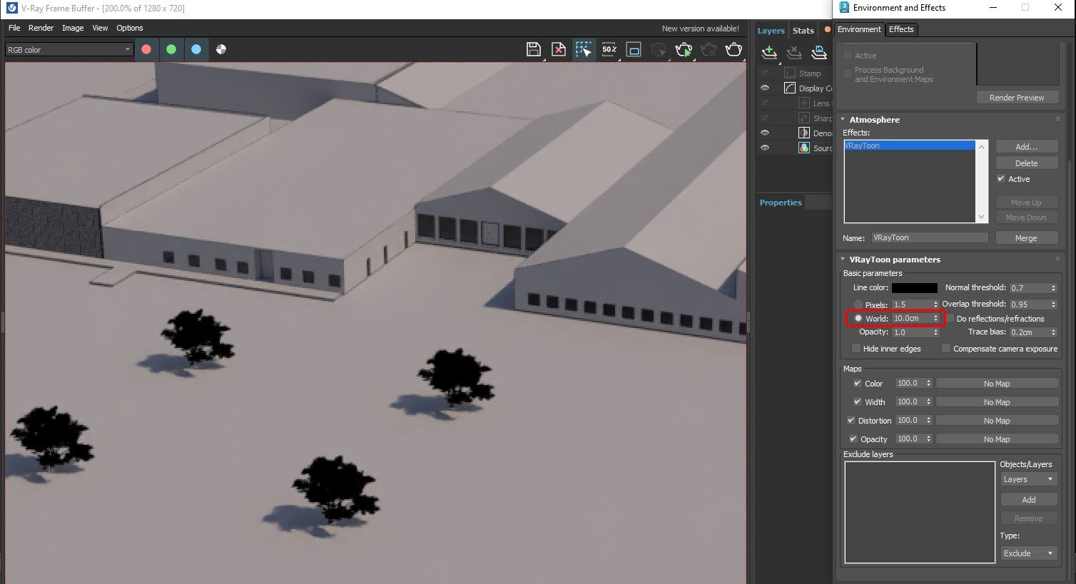

    I have build a simple scene and the Vegetation layer I made is not included in the Toon shader; however, all the trees render black (as if the leaves all have a stroke). Funny thing is that when the Light Cache is being built the trees look fine, but when they start to render they turn black... I have uploaded the 3ds max file and an render to show what I mean here: Chaos Forum Repository

    I think your issue is with the width of the VRayToon lines. The trees have small details like leas and from a distance and with a very thick line they will get black.
    You are using "pixel" for line width - this means that the width of the line will remain the same disregarding the distance from the camera.
    Here are a few examples:
    - line is too thick for the trees

    - line is too thin for the houses

    In order to have the houses and trees with a good looking toon effect you can create two with different line width and include/exclude respectively:

      Thank you for you prompt reply! Sorry I should have been more clear as to what I was trying to achieve. I don't want the trees to be effected by the Toon Shader, and the layer isn't included in the Toon shader. I have no idea why the Toon shader is effecting the Trees, they shouldn't be... any thoughts?
        Hi are you using Chaos Scatter for the trees? There is an issue with Chaos Scatter and VRayToon that is being worked on right now. The scatter can not be excluded from the toon correctly.
