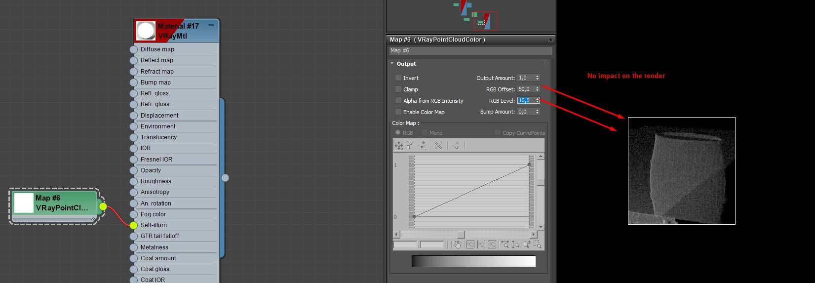

    Hello, I'm trying to render a point cloud by assigning a vray material with a vraytopointcloud map in the illumination slot, but it render black and white instead of colors included into the rcp file when using pixel size, and grey when used real world scale set to 3mm (5mm render black, 1mm render white)
    What I'm doing wrong here, it was looking straight forward but I probably miss something important.
    The file is RCP file but the same behaviours occur with a E57 file.
    Thanks for your input.​

        What do you mean preview the file elsewhere? I can see the RCP in the max windows including the colors without problem as pixel or as real world scale.

            But the color are really washout, it did not reflect the preview.
            The cursor value did not change anything, the RCP is always so whashout that it looks almost grey.
            Using the curve I can get the grey look smore green, or more blue or more yellow, so the map is assigned to the point cloud for sure.
              Ok, found it, it must used pixel size and not real world scale
