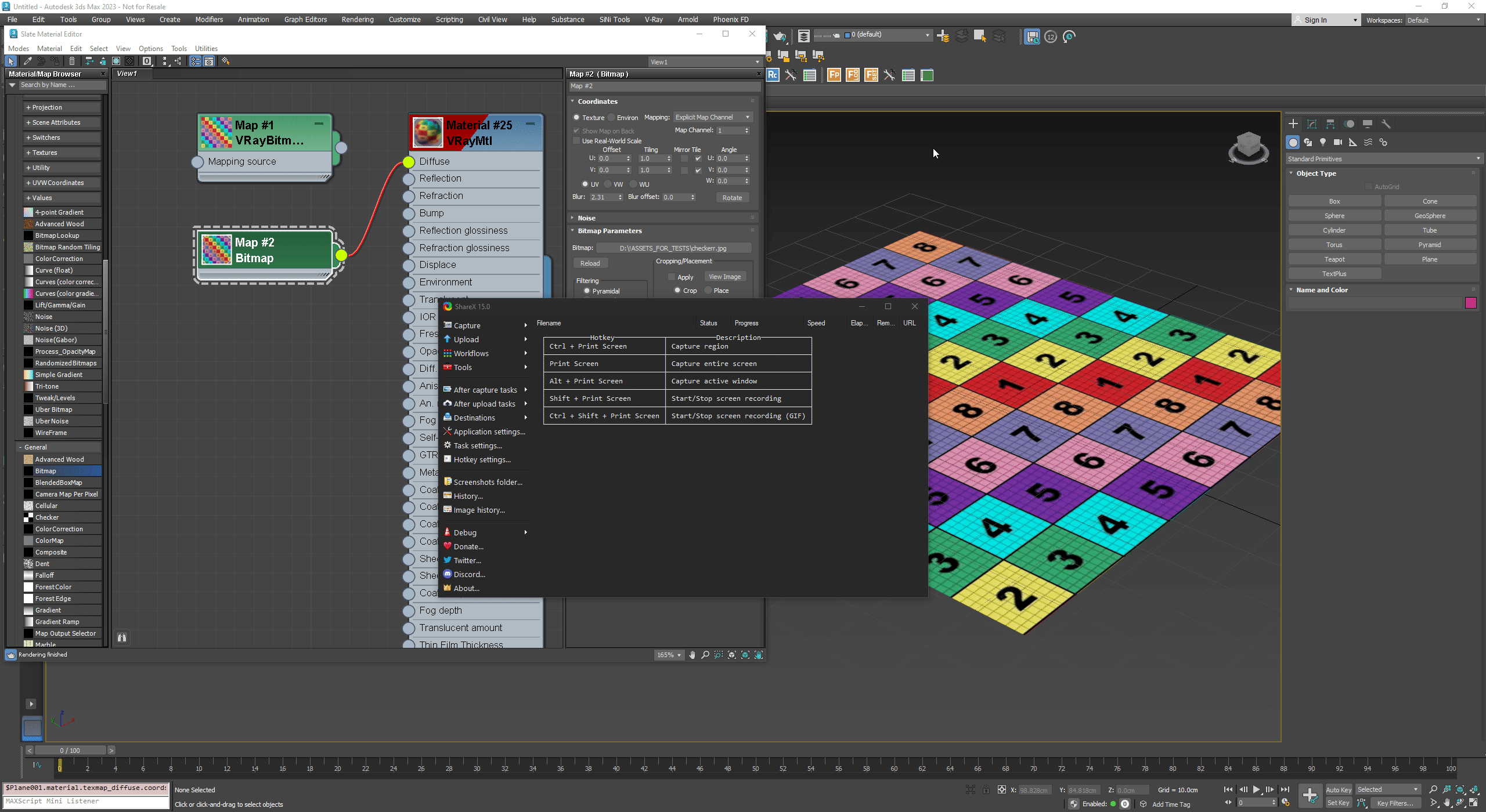

                    The flickering behavior when playing around with the spinners of the bitmap parameters is 3ds Max related - this happens when using max native bitmap node as well and when gradually changing the values of the "Blur" parameter, for instance. I'm attaching an exemplary video: Click image for larger version

                      Hi, I can confirm that this issue also seems to be with previous versions (tested with V-Ray 6, 3ds Max 2020).
                      However it seems to be rather an issue of the VRayMtl in combination with the VRayBitmap. I don't have any of those issues with a Standard Max Material with a Standard Max Bitmap. The Standard Material with the VRayBitmap does have those issues again though.
                      Check out my FREE V-Ray Tutorials
                      • #26
                        Also there is some weird fading happening when playing with any of the values in the VRayBitmap:
                        • #27
                          In a simple test scene where I use Scanline renderer (uninstalled V-Ray for 3ds Max) using only 3ds Max Physical Material and max native bitmap, the same fading can be reproduced when playing with the spinners of the crop values. The fading in general happens when the viewport preview generation takes more time. With VRayBitmap the fading is even more pronounced due to the more complicated filtering behind it. It also depends on the size of the loaded texture. Attaching a video:
