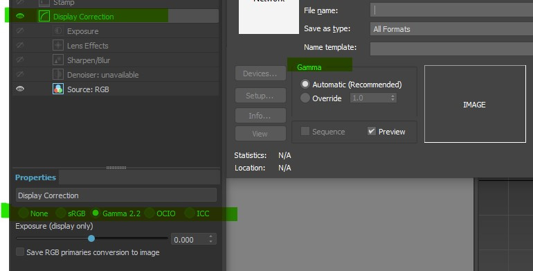

                This is not a limitation of 3dsMax. Every time you save an image in 3dsMax you have an option do save it with gamma transform or without. And if you are saving with some gamma transform you should use the same gamma as view transform in VFB.
                Marcin Piotrowski
                youtube
                CGI OCIO config 04
                  please if possible show with screenshot
Name:	Screenshot 2023-02-26 120159.jpg
                    Automatic means 2.2 if format you are saving to is jpg or png.
