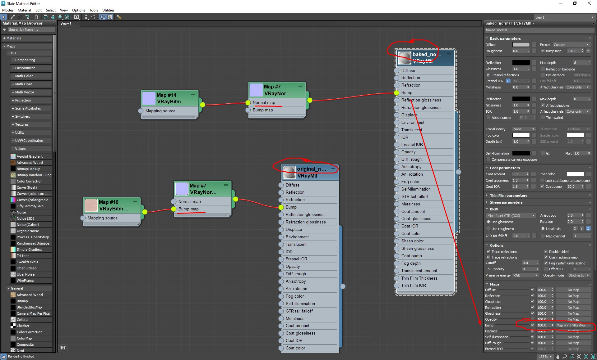

    This problem has been bothering me for a long time, the bake normal not same as the original normal map, the question is simple,
    how to bake a Correct normal same as original normal rendering result ?
    like the attached sample, my original normal bump set 300, baked by max, come out the bump default set 30, the rendering normal bump result is different, even i set the bump from 30 to 300, the result still different (supporse all bump data already save to normal map which i baked out, i should not change the bump, as if i need to change the bump, what bump should i set to make the result same as original?
    I have try to change the Intensity of different parameters in VRayNormalMap, but the bump result still not the same, the bake map can not use on PBR system.

        Hi, there are a few things to point out here.
        If you save your baked texture in exr format your gamma will be fine. But if you use another like for instance png it will be in the wrong gamma and you will need to set it up like this:

        Another important thing is that in order for the bump to look identical you need to bake it with a value of 30 and then after that load it in a material with a value of 100
          Click image for larger version  Name:	3dsmax_2023-04-25_17-56-24.jpg Views:	123 Size:	474.7 KB ID:	1179023
          I'm glad to hear your reply, you still care about customers, as you said "you need to bake it with a value of 30 and then after that load it in a material with a value of 100", Actually I have a question for a long time, is that mean vray only can bake a value 30 bump map?
          1.If my design need a 300 bump like my case ,so vray can't bake correctly? (even vray normal map value or vray material bump value)
          2.As you said after bake my material bump need to set 100, is that a standard parameters? or just lucky this time 100 fit the original normal, next time may not be 100?
          3.I see your uploaded photo, u put the normal map to bump and high mark it, what does it mean? suppose link it to normal map.
          I know I have a lot of bake questions, but those are important to sure vray can work in game industry, We can't find the answer in user manual. Thank you for your support and looking for reply, thanks.
            You have to keep this proportion (30 to 100) when baking and after loading. My screen grab shows the correct workflow, please connect you maps as I did.
