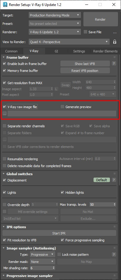

I upgraded to Vray6_1.2 on 3dsMax 2024 and wanted to try out the denoiser workflow for animations. When I set my VrayDenoiser-Element to "only generate render elements" it only outputs RGB and Alpha. Using the standalone denoiser on these sequences does not work. I tried using .png, .exr and .vrimg as output formats - to no avail. Other render elements DO work. When I use It does not work on any of my machines. I'm at a loss here and did not find any clues in the documentation. Right now I'm using direct denoising in my animations but would be thankful for any tips why the recommended workflow does not work for me.
Vray Denoiser does not produce render elements for standalone denoising
