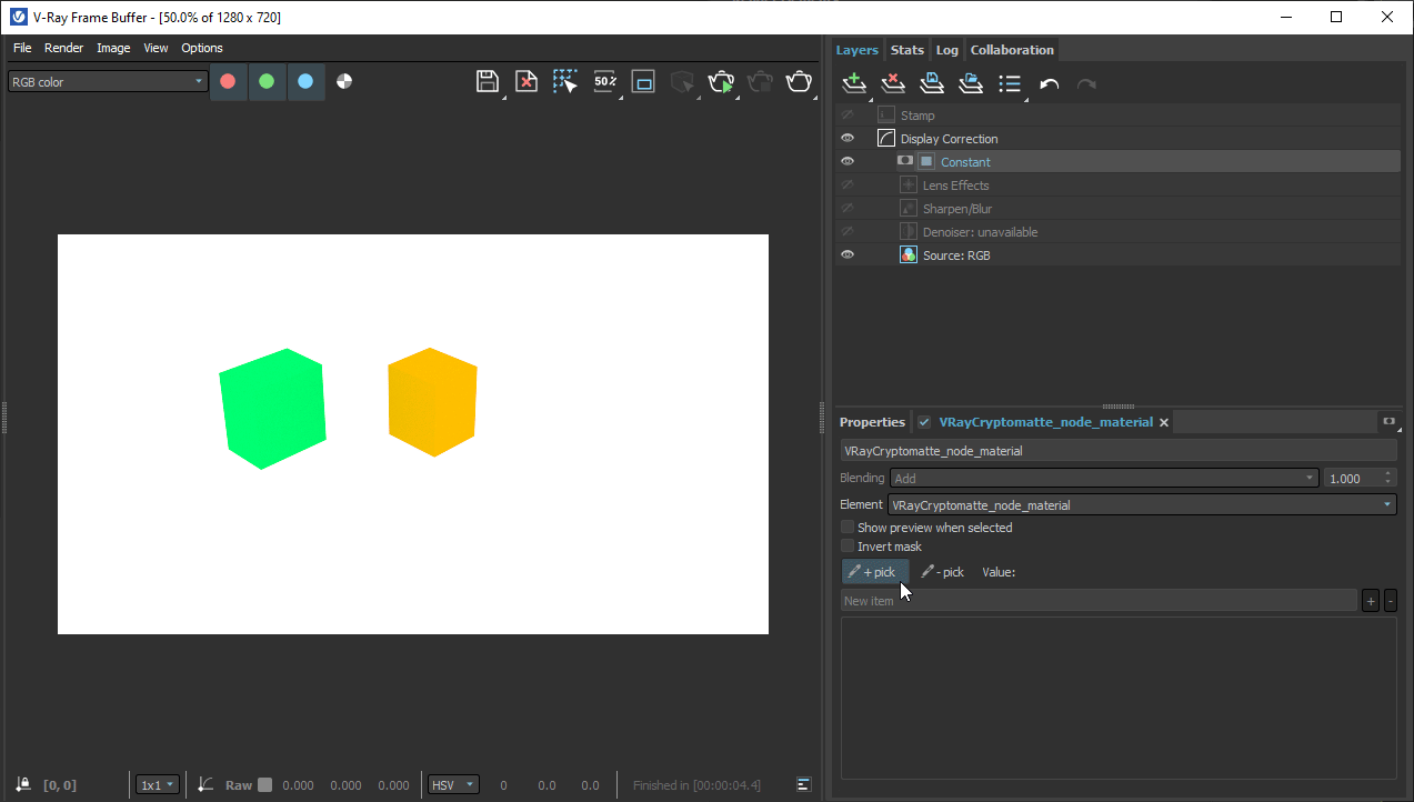

    Hi, thanks for posting. VRayCryptomatte works with xref objects/materials. Here is what I did to test it. Am I missing out something (the yellow box is xref object)?

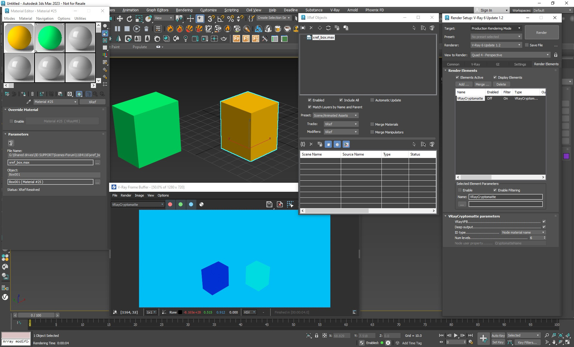

              Hi, I still can not figure out what is your issue with xref object. Here is a recording from my test scene, the yellow box is xref object with xref material.
              Click image for larger version  Name:	3dsmax_2023-06-22_17-49-32.gif Views:	0 Size:	86.5 KB ID:	1184369
              As for the list of objects you are right. It is shared between the two VRayCryptomatte render elements, so when adding object to both render elements they are stacked in the same place. They both work though and each one knows it's objects. We will consider adding separate lists to each VRayCryptomatte render element if this is technically possible.

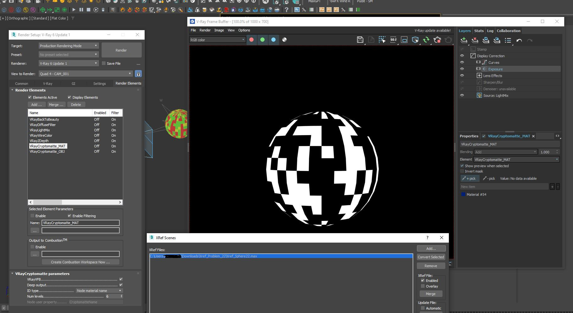

                Ok, now I see, MultiSub Object materials in Xref materials, don't work with CryptoMatte
                Click image for larger version  Name:	XrefMatCrpyto.gif Views:	0 Size:	1.69 MB ID:	1184374​

                  We are always working on large scenes with many xrefs in our studio and never had problems with MultiSub Object materials in Xref materials. Granted that we use EXR.io to get the selections inside PS for post work. I replicated your scene and it seems to work ok in the frame buffer also. We are on Max 2022 and Vray 6.10.04.
                  pixel bender @ panoptikon
                    That is extremely weird, what am I doing wrong? I've attached my scene to this post. I just tried to recreate in a fresh scene and it still gives me these results.
                    Can you test if it works with any of you? I'm on Max 2023 with Vray 6.10.08 though. Thank you, this is very annoying.

                      Can you please save the file in max 2022?
                        Here ya go. Thanks for testing. Not sure if it isn't version related ofcourse.

                          Well it seems to me it is version related. I'm not sure if vray or max. Maybe the devs can help us out with that information.
                          I've tested your file and it is working ok.

                            Very weird, thanks for testing, right now I have about 50 plants and trees loaded as xrefs, so I have to manually go through all of them and assign them their none-xref material. Hope Chaos can confirm soon and come with a fix.

                              Hi garipodelu you are using x-ref scene that is why it works in your case. We are testing x-ref object setup and it does not work in none of the versions I tested. I will talk to the developers about the VRayCryptomatte for x-ref object.
