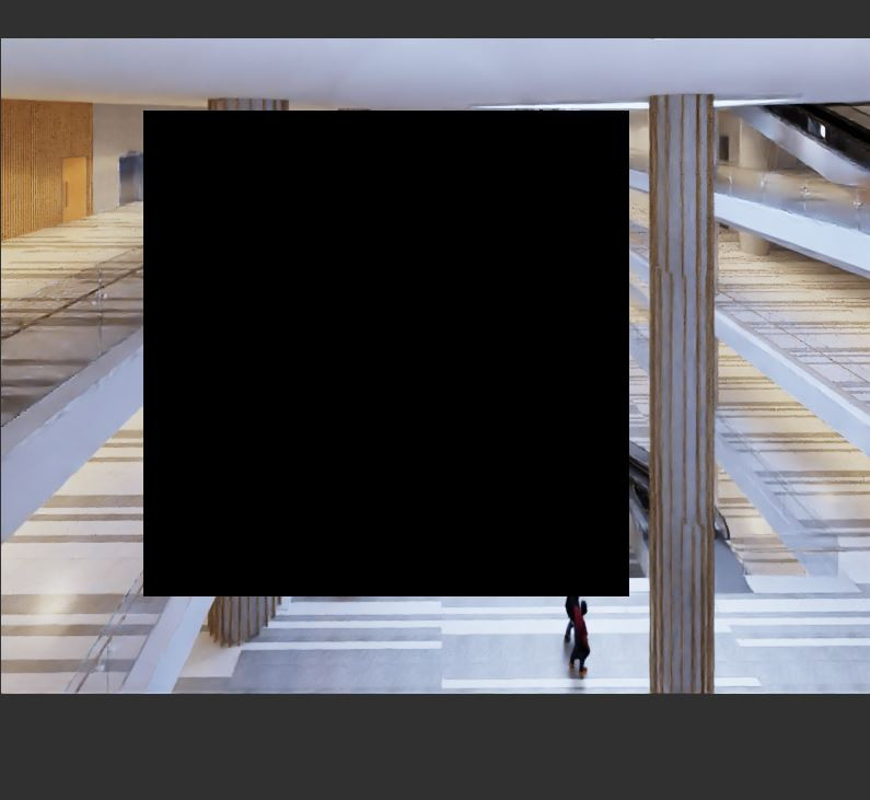

No warning sir...just to confirm that it happen on bucket render too, the black square change to white square ni TIFF format.
Graphic card driver is up to date
for your info, i have been working on the same file since last week, and have render no problem, the black square problem just appeared few day ago randomly
While I was waiting for my manager respond, I have do some test on the file and try to solve the black square issue, and I noticed that all the glass render in white color with no reflection and refraction if I turn the "affect channels" to " all channels"
