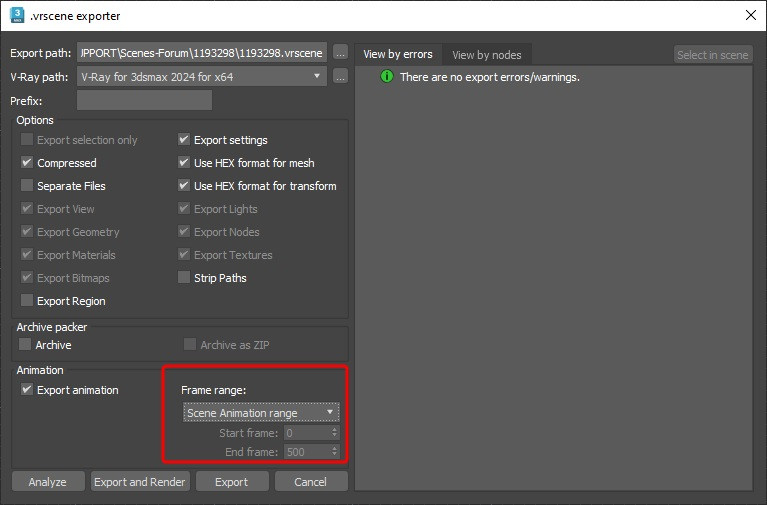

            Are you are able to export the whole animation range as seen in the 3ds Max's timeline.
            There is also a setting for this in the vrscene exporter
