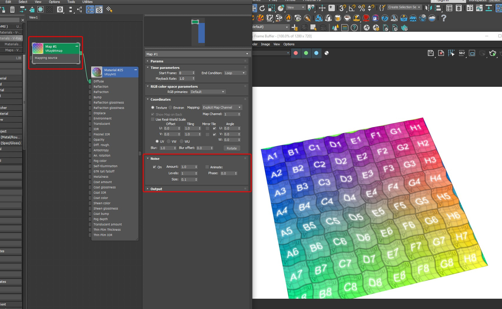

    Hi, thanks for posting. You could use VRayBitmap. It has a built in noise that you could enable and adjust:
