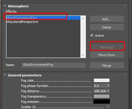

        Hi, thanks for the scene.
        If you move the VRayEnvironmentFog above the VRayAerialPerspective in your scene it will work.
