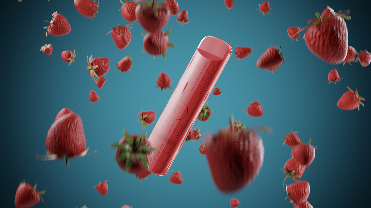

      The first attachment is a screenshot of the VFB, the second one is how the saved .exr looks like in Photoshop and After Effects.
      My first impression was that the .exr lacked VFB's tone-mapping. I removed it and the image in the VFB looked more desaturated than attachment "b", so that's probably not the case.
      I'm also attaching a screenshot of the VFB settings, which are practically the default ones, save for the tone-mapper.

        What are your Color Management settings? Also, does the difference occur if you save the image with the "Display correction" baked?
