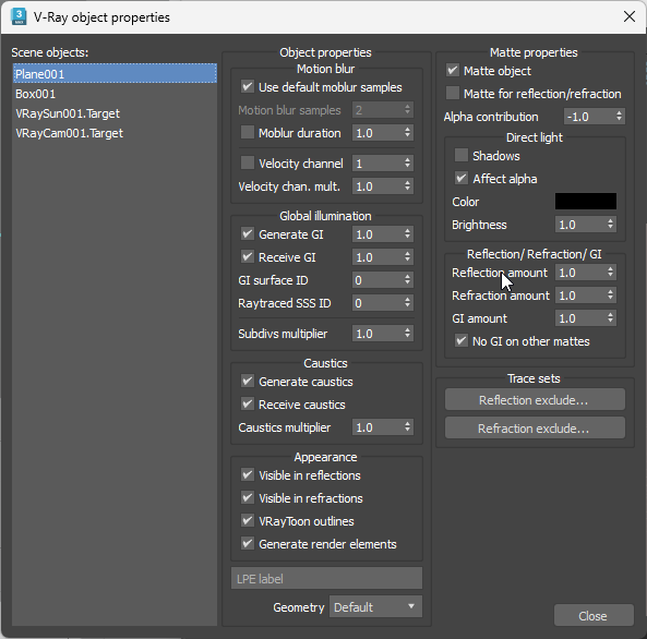

      Hi, thanks for posting. If you want to use render elements over the matte object you have to render twice. You could use the alpha from the matte pass as a mask.
      In my test there is a plane and a box with reflective material. With these settings for the plane (the matte surface):

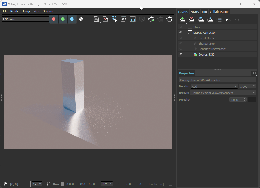

      You'll get this for the Alpha and RGB
      This Alpha could be used as a mask to adjust only the reflections that are over the plane.
