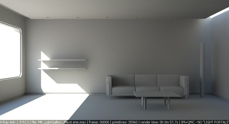

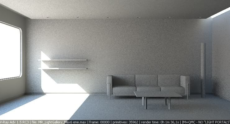

                    other than being surprinsingly noisier...it doesn t look nothing near to ur "tests"...so id check ur "bug" consistency...
                    Nuno de Castro
