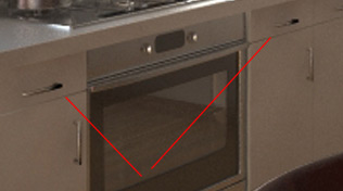

    2. I have a chrome material. It's black diffuse, grey reflection, reflection glossiness set to .85, and ward. It used to render fine, but now I'm getting black areas on objects with this material. It seems like not enough light is hitting these spots.

            Can you archive your scene and I'll take a look, your door handles look like a smoothing problem, try resetting the smoothing groups. as for the lighting i would need to have a look, but im sure its just something you have over looked.

              Hi jujubee,
              I took a look at the scene and it is the smoothing, take the smoothing off and it goes away, see below. For some reason Ward doesn't like it, Probably how the mat is supposed to react with that much blur with the glossy... Switch it over to Phong and it works perfectly fine with smoothing on.
              Smoothing on
              Smoothing off
              N
