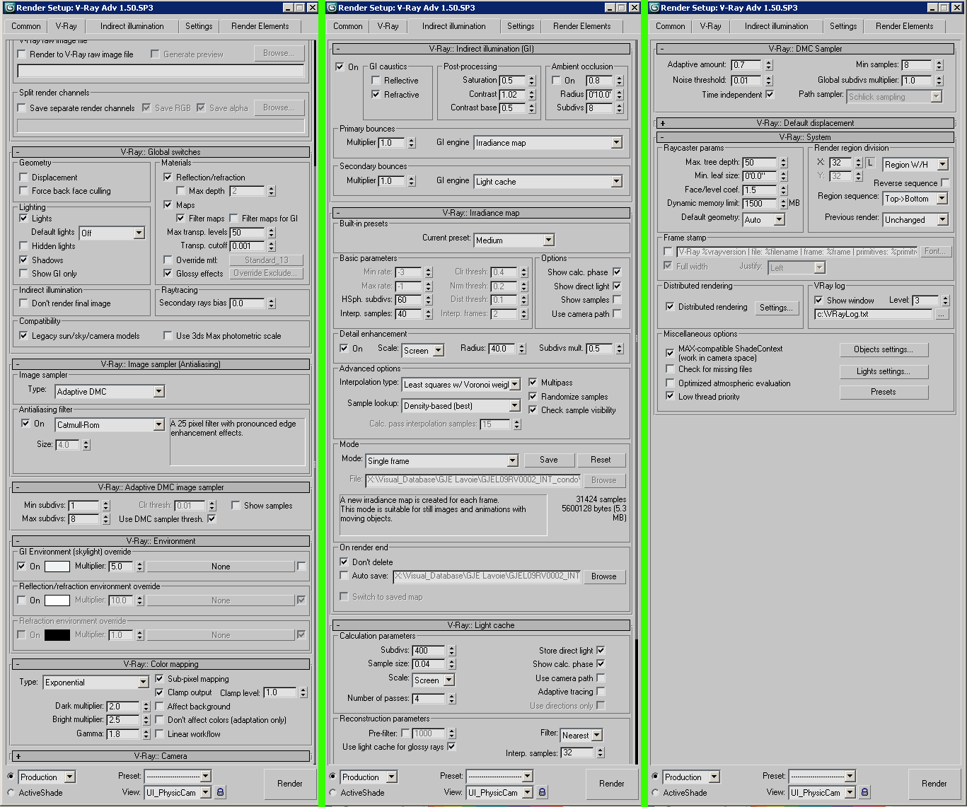

                  8 inches for interior part and 4 inches for the brick....
                  _____________
                  OZRAY, 2009.
                    Do your walls have a thickness or are they just planes?
                    It really seams to be the case here!
                      To be honest i think your Vray settings are a little Whack ... i suggest resetting vray and starting again, its not a SP3 issue something like that would have been noticed a long time ago.
                      Try these settings and see how you go, if you still have problem email me the scene, nathan@rendertime.co.uk
                      have a look ..
                      Natty
                      http://www.rendertime.co.uk
                        I think what you are seeing there is poor quality Light bounce ..

                            • #15
                              Try those settings first ..
