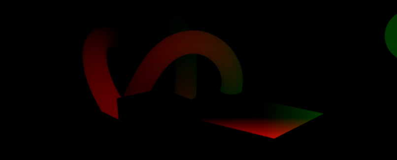

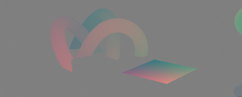

                So I try with Multilayer EXR, and it work great. So I investigate a little and the multilayer EXR VrayVelocity look like the first attachement (non-moving objects are black), the vrayvelocity element is the second attachment (non-moving objects are middle grey).

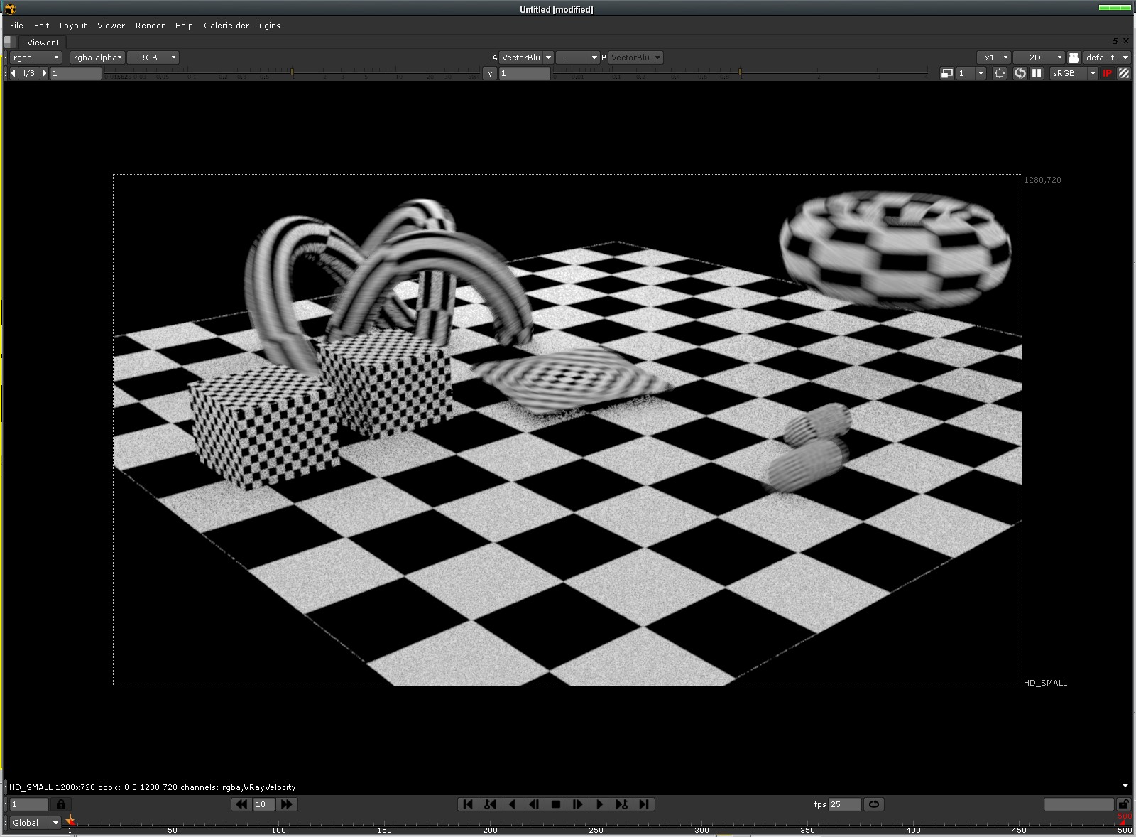

                So I add a color lookup to my comp to get the non-moving objects black, like in the multilayer EXR and it works. (compo on attachement 3)
                Thanks for the help !!! Hope it helps other peoples...

                  you shouldnt have to do a color lookup. We use VectorBlur quite a lot and it works out of the box, so i am not sure what's going wrong there.
                  Edit: Just gave it a quick go. Works like a charm here (see screenie). Let all
                  settings in max untouched. In Nuke piped it straight into the Vectorblur without any additional nodes and then just selected VRayVelocity, set mode to forward (better quality) and set the alpha in the VectorBlur (to add proper edge handling).
