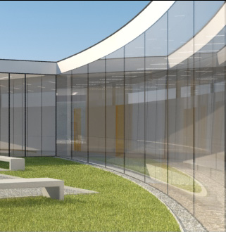

    hi there,
    once again i struggle with a problem i thought of i solved it yet.
    i posted about the issue that i get distorted effects in rounded glass objects before, and got a lot of good advices, also that one that the glass object needs to have "thickness"
    my problems were solved then when i imported a double line from cad and extruded it.
    now i face the same problem in another object with a rounded glass object again, and now the problem stays also when i import and extrude a double line from cad.
    QUESTION: WHAT IS THICKNESS?, how do i create an object with thickness so that i don`t get these problems again

          thanks for your replies,
          as most of you still think my glass geometry is a plane i will describe how i made it.
          1.) in autocad i made a closed polyline of the glass which surrounds the patio out of the floor plan.
          2.) with "offset" in autocad i made a second polyline with the distance of 1 cm
          3.) i imported the layer where only these 2 lines where on in 3dsmax and extruded it there
          4.) i added a glassmaterial with a falloffmap in reflection, ior 1,5, (max depht 5 as there is no other glassmaterial in front or behind my glass)
          5.) rendered, and got the distorted effect
          6.) posted...

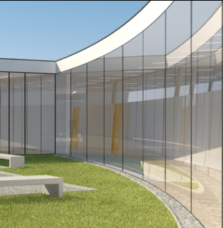

          7.) added a shell modifier with inner amount 1,0....and got the distorted effect still
          8.) changed the shell modifier to outer amount 1,0, and the distorted effect is gone, but my glass and the romms behind it are darker now(which i would like to avoid)
          i just want to understand why i get the distorted effect on rounded glass, when i make my glas object as i described it above(polyline, offset, extrude)
          this is not a plane, the material has "thickness", or am i missing something? i would like to build to avoid the shell modifier as this darkens the rooms behind the glass
          would be very thankfull for explanaitons, to know how i have to build my glassobjects in the future

                through the assistance from codi i know now how to fix the problem.
                (smooth modifier, autosmooth enabled, value 1)
